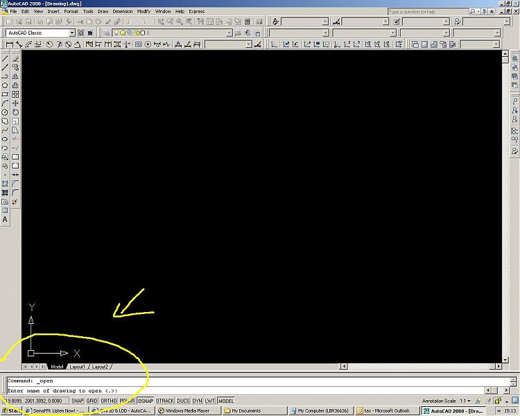

Most of the time I use Auto Cad classic, but sometimes I need Civil. But when I try to start Civil I get the same options as for Classic (picture a).
When I am in AutoCad Classic and try to save as… or open a new drawing I don’t get a pop up window as usually but text in the command line (picture b,c) Does anybody know what happened and could give me some advice please.

Try the "filedia" command, and set it to 1. Somehow it gets set to '0'. Usually the culprit is a lisp routine that sets it to '0', but then gets interrupted before it sets it back.
As for why your civil space looks like the classic, I'm not sure.
Wow cool, thanks a lot. One problem solved
