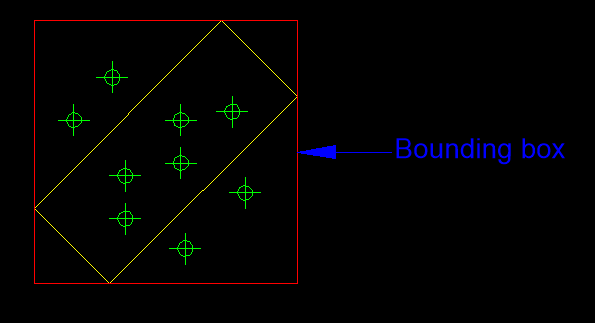

It is better to use the co-ordinates of the pline rather than bounding box, compare a rectang at 45 angle may get stuff outside of rectang. Still use "WP" co-ords
Sure. But sometimes you have to look at the example drawing. 😉
