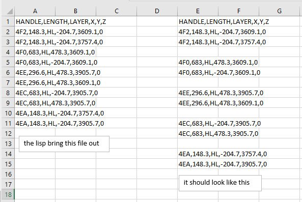

Hi, i have this file.
How can i make a new line after
each different "HANDLE"?
(each line should be in a group)
My secound question is how can i select a filename
for the .csv export?

Item 1 explain more
Item 2 its up to you, stuff like dwg name and location, one directory always. Enter a filename and location. Need more info.

To let the program targets only the desire objects names, then just replace the filter of the ssget function as follows.
Replace this:
(ssget '((0 . "*LINE")))
with
(ssget '((0 . "*POLYLINE,LINE,SPLINE")))
Then you to add a blank line, add the following code in the same position as follows:
    (t (prompt "\n...invalid item selected. Ignored.")) ;; so this line of codes not need anymore.
  (write-line "" f) ;; <- Add this lilne of codes to get a blank row.
If you want blank lines then you will need to write to a list, sort  it, what you do then is look at next variable in the list is it 4FO 4FO 4FO when its not do a blank line. I will try to find some sample code. Its a nth x compare nth x+1, I have used this method a lot for counting common objects. Some one may have something already.

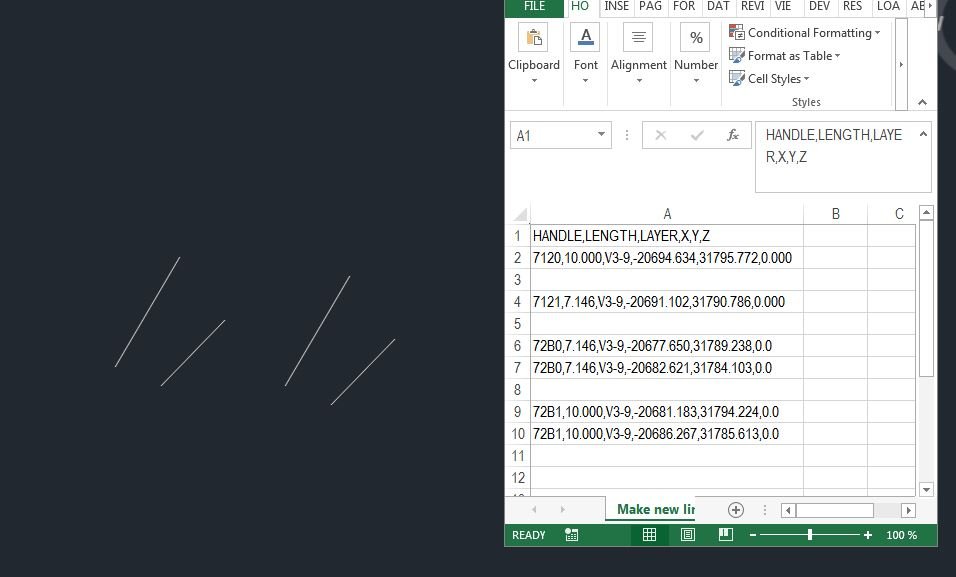

(defun c:TESTL2C ( / *error* A CNT E EG EN F FNAME HAN LEN LYR PNT PTLST SS TMP TXT TXTL TYP)

(setq ptLst(vl-sort txtL '(lambda(a b)(<(car a)(car b)))))
  (setq fName
		  (getfiled "Save CSV File"
			    (strcat (getvar 'dwgprefix) (vl-filename-base (getvar 'dwgname)) ".csv")
			    "csv"
			    45
;prep file/vars
(vl-load-com)
(setq f (open fName "w"))
(write-line "HANDLE,LENGTH,LAYER,X,Y,Z" F)
  (write-line (caDr (NTH cnt ptLst)) f)

Hi Tharwat, hi hosneyalaa,
thank you for your articles.
Tharwat, I adapted the code as you wrote it and it work fine.
hosneyalaa your suggestion with the sorted list is a good idea that I can use.
I wouldn't have thought of that.
Thanks a lot for help.
