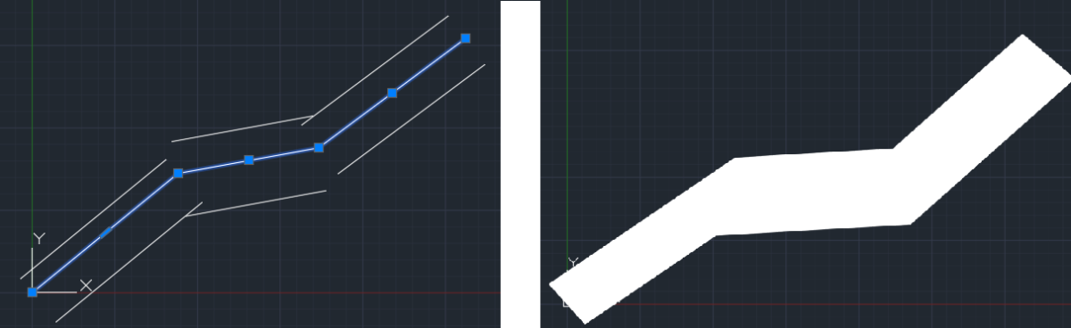

I've tables containing thousands of rows of bearings, distances travelled from previous point and distances of obstacles on the left and right side of a vehicle. What I need to do is to draw obstacles on the road. I tried drawing multiple polylines but I realized it is not good enough. It is important to visualize measurements of individual sides, not just road width alone.
I though about drawing a center polyline and offsetting left and right measurements. These offsets are obviously different for every segment and filling thousands manually is a no-go. I would like to compare the sketch with a map, but first I need to use the data to draw lines, rectangles or anything, that would interpret the collected data visually.
Sorry for my "non-technical" level of english, I have trouble describing the problem in my native language as well. Hopefully the screen attached will make my question clear. It would be great if the result would look like the one on the right side (thick polyline - but I would need to be able to set left/right thickness), but the left one using offsets would be sufficient.
Last resort would be converting all the measured points to coords by calculating all the angles using some scripts, but I hope there is a more elegant solution to this.

There should not be a problem doing a centreline and left and right offsets as well, you need to provide a sample data file.

This should help
(setq obj (vlax-ename->vla-object  (entlast)))
(vla-offset obj x)
where x is positive or -ve value eg 10 -20
I would try a slightly different approach, rather than trying to work out a point (position) that is +/- use the 'distances' you have for right / left and the angle of the line -90 and +90 the multiple option of th offset command will allow you to enter multiple values so your offset command would become
_OFFSET T M 100<-87.5 50<92.5 E
In this example the right offset is 100 and left 50, you would only need to work out your new angles and in this case that was 2.5 - 90 = -87.5 and 2.5 + 90 = 92.5

Well, BIGAL pretty much answered your question. Using vla-Offset will do just as fine.
A positive value would indicate offsetting to the side that would result in the longer curve length. And if the curve length will stay the same, the the offset would be to the positive x, y, and z coordinates. A negative value would indicate otherwise.
