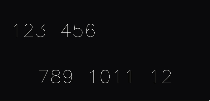

Hi,
I have a large number of strings that contain between 7 and 16 characters.
Does someone have a lisp that will remove all but the last 3 or 4 characters. The 3 or 4 characters being defined by the user
eg 3 character  original "123 456 789" = "789"
or 4 characters original "123 10.5 15 1234" = "1234"
Thanks in advance for any assistance.

(defun _last_str (str / n)
  (if
    (setq n (vl-string-position 32 str nil T))
    (substr str (+ n 2))
    str
_$ (_LAST_STR "201 1 13 124")
"124"
_$ (_LAST_STR "201 0.5 14 2301")
"2301"
_$

Strange .. works here. Remove all characters at the last space.

Taking Stefans idea a bit further.
(defun c:txtlast ( / ss txt txtlst obj)
; thanks to Lee-mac for this defun
; www.lee-mac.com
; 44 is comma
; 32 is space
(defun _csv->lst ( str / pos )
    (if (setq pos (vl-string-position 32 str))
        (cons (substr str 1 pos) (_csv->lst (substr str (+ pos 2))))
        (list str)
(setq ss (ssget '((0 . "TEXT"))))
(repeat (setq x (sslength ss))
(setq obj (entget (ssname ss (setq x (- x 1)))))
(setq txt (cdr (assoc 1 obj)))
(setq txtlst (_csv->lst txt))
(entmod (subst (cons 1 (last txtlst)) (assoc 1 obj) obj))
Multi radio buttons.lsp
