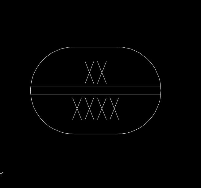

I use a custom toolbar full of dynamic blocks to create P&IDs with editable attributes. Once the P&ID is finished, I use the ATTOUT command to create a TXT file which the project engineer can then either edit, so I can use ATTIN to populate all of the fields on the P&ID or they use it to build an valve and instrument schedule.
The problem I have is surrounding my block for instruments. It is a really simple block with one multiline attribute and three visibility states to choose local instrument/remote control panel/local control panel.
My issue is this. When I do the ATTOUT, in the txt file, the muliline text is displayed thus: \W0.6000;XX\PXXXX. Is there any way of getting it to just display the text or is there another way of splitting the text without using multiple attributes? I would really like the text to just display in the txt file as, for example, LSH1202, (level switch high 1202), instead of \W0.6000;LSH\P1202.

It's not a problem specific to this particular block. It affects any block where an attribute is set to multiline text. I always get the \W0.6000;XX\PXXXX format. I would like to know if there is a way of stopping the \W0.6000; & \P text from displaying when I do an ATTOUT.

You can remove the formatting or do something else with it the \P is next line. \W0.6000;XX\PXXXX \W a guess width. so its
XX
XXXX
Via a program rather than attout can be done simply as thanks to people like lee-mac there is strip Mtext.
