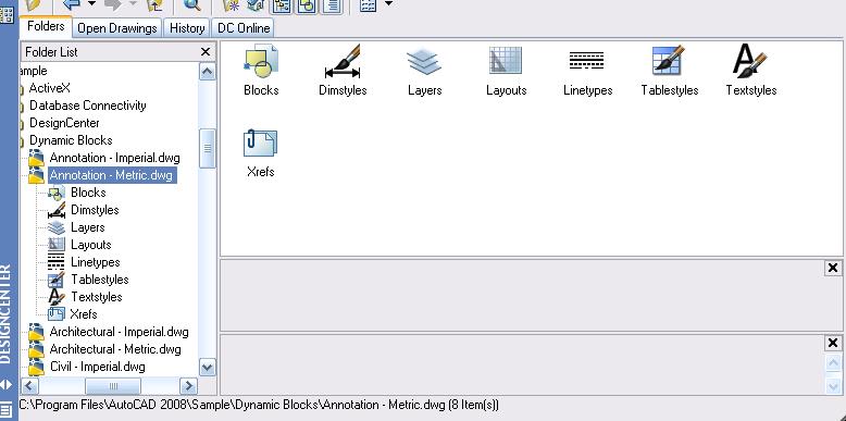

stevsmith Posted February 9, 2009 Posted February 9, 2009 Which image looks like the page you are trying to grab from? . Quote

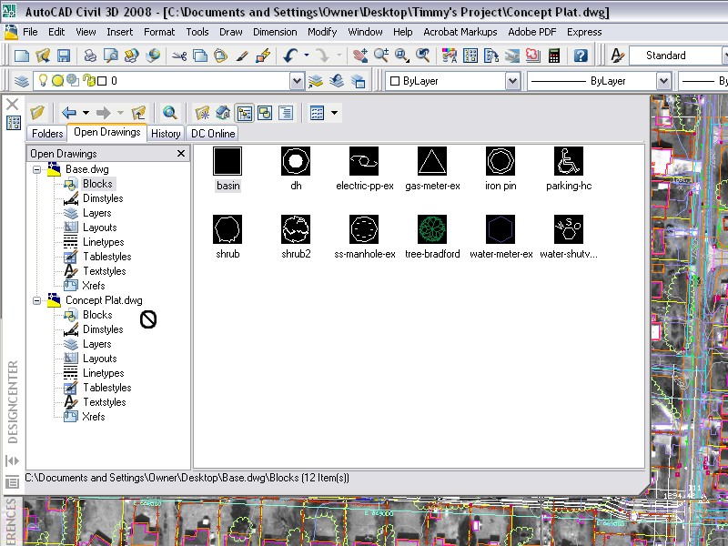

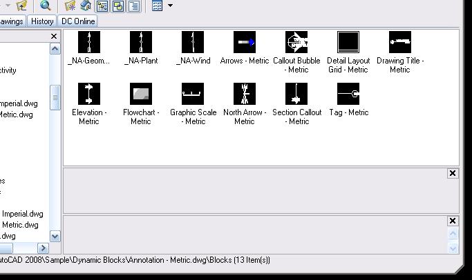

stevsmith Posted February 9, 2009 Posted February 9, 2009 The 2nd page is what will come up when you double click on the blocks icon. You cannot simply drag the "blocks" icon from image 1, you have to open this and individually select or range select from the blocks in page 2. I hope ive described this ok (Edit) HAHA.... ok Image 1 will not let you drag. Image 2 will let you drag and copy. Quote

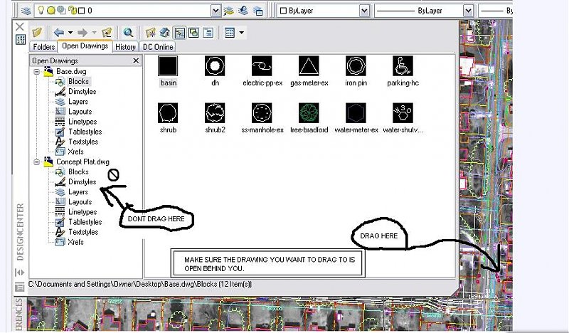

cwall25 Posted February 9, 2009 Author Posted February 9, 2009 I have tried both images. I thought that the first image is the one that I needed to do though. Whenever I start to drag the object (layer or block), I get a circle with a slash through it, similar to the picture below. It seems like I am blocked from copying or dragging. Are there any settings, or do I need to reinstall? I am lost and I would like to use this feature. Quote
cwall25 Posted February 10, 2009 Author Posted February 10, 2009 I feel dumb!!! You are the man. That has worked on everything I have tried. Thanks so much, you have made my life easier. Quote
