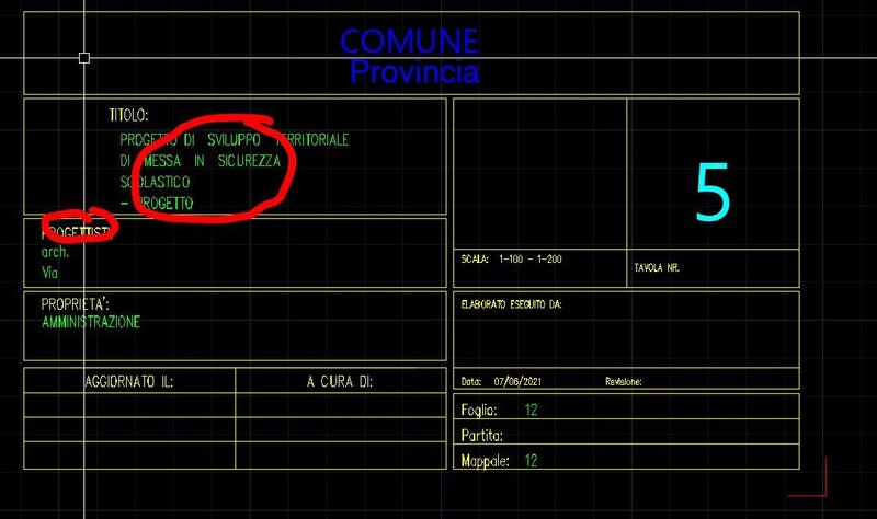

How do I change the font at the same time, so not line by line of this block? Thank you
Cartiglio.dwg
Find out the Text Style of the font you want to change, then change the font file to suit
Have properties open, Bedit the block, choose all the attribute text, change the font style, save the block. Then Attsync the block you should see the changes.
