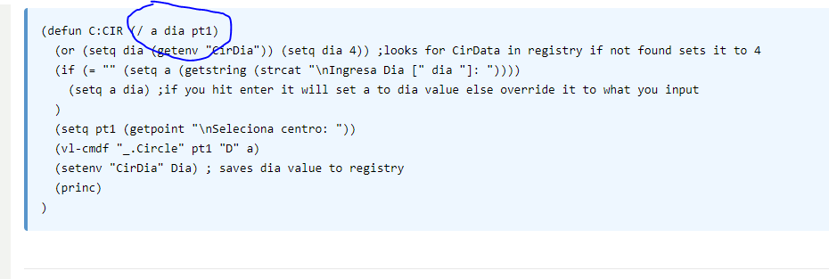

WHY ARE VARIABLES PUTTED BETWEEN PARENTESIS?
WHAT IS YOUR FUNCTION?
variables within parenthesis:
( x / y )
x are for anything passed to the function when it is run typically from another function
y are local variables used only for this function. If you don't define y here they become global variables and their value can be used by any function - global variables can mess things up if you aren't careful. Unless you need to, define all variables as local and put them in these parenthesis

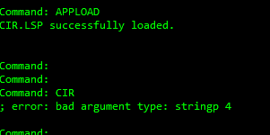

SOMETHING IS WRONG THAT DOES NOT WORK
Sorry my code was wrong. when running for the first time it was setting dia variable to 4 but as an integer.
this caused an error in the if statement because it needs to be a string.
changed (setq dia 4) to (setq dia "4") so its stored as a string.
Also wasn't storing the correct variable in CirDia to have the updated input.

UFFF   I CAN'T BELIEVE IT KEEP MARKING ERROR
no my dumb ass made a few mistakes should be fixed now.
  • Funny 1
MY FRIEND DOES NOT WORK
You might be using the old lisp still to reload the lsp file drag it from your explorer into autocad and drop it
the attached lisp is working for me. Also this is saving in the windows registry so if your using a mac or don't have permission to change it this might not work.
