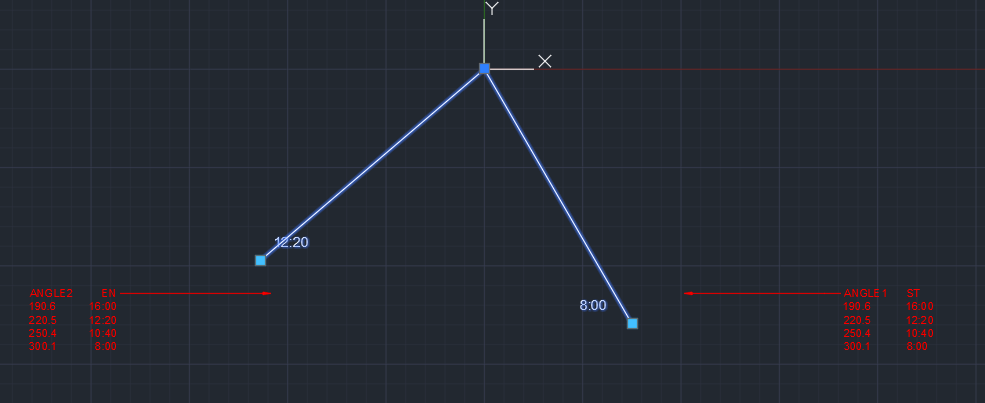

Hi,
I would like to set attribute value according to the angle parameter of dynamic block (there is a list of angles and value for each angle)
Inside my block there are:
- two parameters Angle1 and Angle2 which are defined by list of angles (190.6 , 220.5 , 250.4 , 300.1)
- two attributes ST and EN which needs to be defined by values list (16:00 , 12:20, 10:44 , 8:00)
As I move the grip by mouse I would like to set the value of ST or EN according to the list of values above. Behaviour would be similar as if I would use Block Propereties Table but in this case both values ST and EN needs to be separated from each other. Dynamic block does not allow me to create two Block Properties Tables. List of Angles and list of values will be much larger in the future so I will change them for every new project (I plan to do it manually from Excel)
Is it possible to get some help with simple LISP definition to set attribute value by angle according to the list of values? DWG attached. Thanks a lot for any feedback.

This is solved with a reactor, loaded at the beginning of the AutoCAD session. At each change of angle, the corresponding attribute is updated.

Hello @confutatis,
thank You for the quick responce and briliant script. I've managed to set all my values list in radians with the proper desription (in Excel)
Unfortunatelly, I don't know how the script inserts ANGLE1 value into ST attribute and ANGLE2 value into EN attribute. It seems that it works randomly.
Is there a way to set that values from ANGLE1 goes always to ST attribute and ANGLE2 to EN attribute?
Again many thanks for the code!

Hello @confutatis I would like to again thank You for quick responce and code. After a while I understood my misteake. I didn't notice that there are two different functions used for attribute assignment - CAR and CADR. Now I see what's the diferrence :)
Car, cadr and caddr, the first, second and third elements of a list, are normally used to extract x,y and z co-ordinates. To extract the elements from the fourth upwards, combinations of car and cdr (caar, cdar, cddr, caaar, caadr, cadar, caddr, cdaar, etc.) are used or, more simply, the nth function.
Syntax:
(nth n lst)
Arguments:
n - the number of the element to return from the list (zero is the first element).
lst - the list
Return Values:
The nth element of lst. If n is greater than the highest element number of lst, nth returns nil.
I could also write:
(nth 0 attr) and (nth 1 attr)
Edited by confutatis
