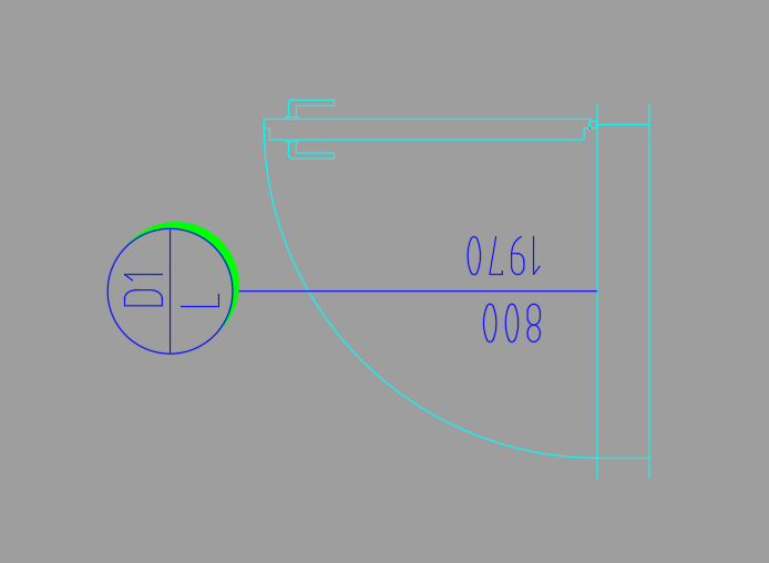

I need help with rotating text in block. When I rotate my block about 90 degree than my text is upside down i will put here screen:
Is there some way that text would stay 90 degree with door but not upside down. Thank you for your help and tips.

You may need the text to be in a visibilty state dependent on angle of block. Need say 2 states.
thanks and have can I do that ? 🙈
I don't play much with dynamic blocks, but others are very good at them, so post a dwg with the block.
