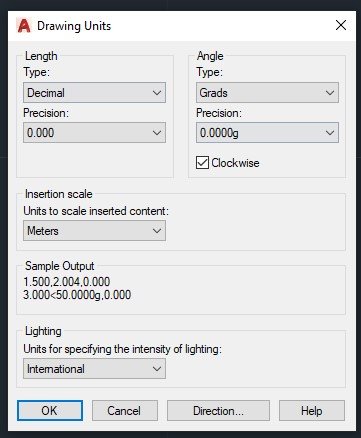

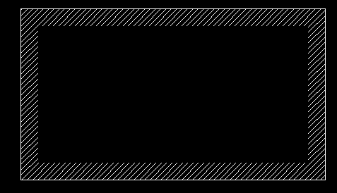

Hi i am using this code to hatch buildings. I need  some changes
1) All the timew the offset = 0.50
2) hatch pattern =Line
3) hatch scale  =0.125
4) harch angle = 50 grads
I upload my template  units

It should work, I haven't made any major changes. Removed the part about the offset request and put, as you said, always 0.50. In the end I inserted the new hatch with the features listed, changing the units of the drawing, which I have on decimal degrees.

That's it, now it also handles the lines.
