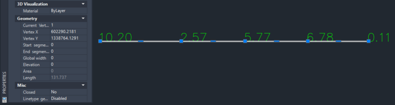

Hello. I want to convert 2D polyline to 3D polyline with text at vertex. Can you help me?

if i understand right this text is the elevation ?
Quote
Yes.
