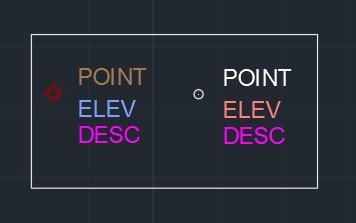

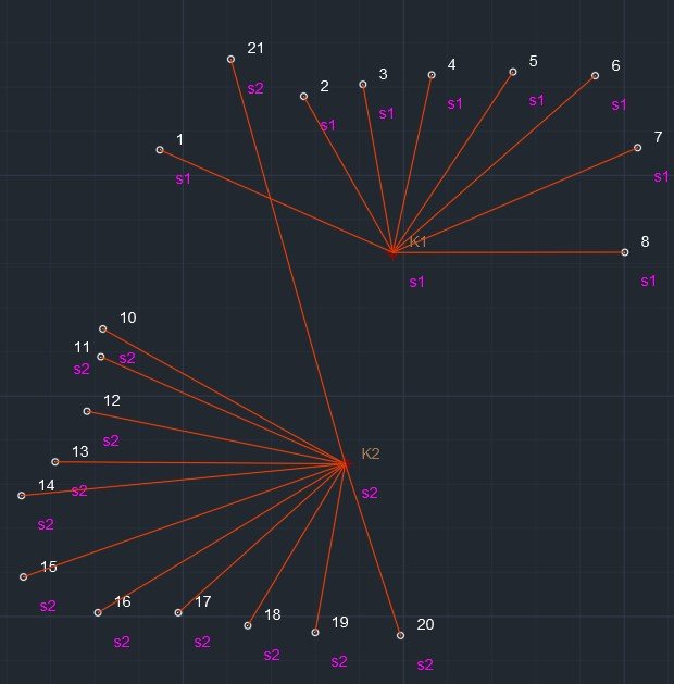

Hi .i am using block attribiutes for my topografic drawings. I use two type of blocks (annotation and non annotation). From stations i use AnnotSTATION,STATION and for the other points i use  AnnotPoint,Point. Each block has POINT,ELEV,DESC (like img 2). I want to connent with line  for example the station K1 with DESC S1 with all points with DESC S1 . The idea is to conect with line the AnnotSTATION,STATION block with the AnnotPoint,Point with only filter the same DESC name.
Thanks
TEST.dwg STATION.dwg Point.dwg AnnotSTATION.dwg AnnotPoint.dwg
Hello, i dont know if this is what you looking for but you can try it.
First select is for Staion points.
Second select is for Base points.
command: try1

	(setq sscord2 (ssget (list (cons 0 "Insert")(cons 2 "Annotstation"))))
	(setq ssbase (VaniVL sscord2 "Try11"))
	(setq sel2 (ssget (list (cons 0 "Insert")(cons 2 "Annotpoint"))))
	(setq sspoints (VaniVL sel2 "Try12"))
(vlax-for x ssbase
	(vlax-for y sspoints
		(if (equal (LM:vl-getattributevalue x "DESC") (LM:vl-getattributevalue y "DESC"))
				(T:eLine (vlax-get x 'InsertionPoint) (vlax-get y 'InsertionPoint))
