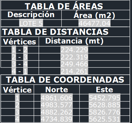

Manuelmfec Posted July 27, 2021 Posted July 27, 2021 Hello dear AutoCAD community, I am developing a small Autolisp routine that allows me to convert a selection of (texts with fields) into normal texts while preserving their value. The texts with fields are grouped in a table with the command "_group". The routine process would be as follows: 1) the routine allows me to select the group (the grouped table) "group1" and then filter the texts with fields according to their style in another select "group2". 2) the respective conversion is carried out. 3) Once the conversion is complete, the table and its components are regrouped in their entirety with the command "_group". End of the process. I have already tried many attempts and have not been able to get the main part of the routine (process 2). I ask you please to help me achieve the result described above, I am attaching a dwg with small examples of the tables I work with and the autolisp code that I have been able to achieve (process1 and process3). I am looking to perform this routine since these tables in my work usually have up to 100 rows and converting each text with field one by one takes a long time. Thank you very much for your attention !!!!! (DEFUN C:3XDM () (SETVAR "CMDECHO" 0) ;PROCESO1 (SETQ GRUPO1 (SSGET)) (COMMAND "_UNGROUP" GRUPO1) (setq GRUPO2 (ssget "P" '((0 . "TEXT")(7 . "MFEC2")))) ;PROCESO2 (setq LONG (sslength GRUPO2) ) ;PROCESO3 (COMMAND "_-GROUP" "_C" "*" "" GRUPO1 "") ) PRUEBA DE COMANDOS.dwg Quote
BIGAL Posted July 28, 2021 Posted July 28, 2021 (edited) My take on this task is to make "TABLE" objects as this does the grouping for you a Table supports fields. So you would have 3 tables not linework and text looking like a TABLE. So running a remove field keep value in Table is what you want. I am pretty sure that at least 1 of the generate a table of Lots/Plots already exists. If not all your required tables. I think I have seen a table with all 3 combined into 1. Need to google. Try the "Table" command. This would be one table created using a lisp. Edited July 28, 2021 by BIGAL Quote

BIGAL Posted July 29, 2021 Posted July 29, 2021 As I said for correct reference with Autocad objects they are not Tables but, Lines and text to look like the common term a Table. Quickest way would be convert to a "Autocad Table" its not that hard to read the columns of text/field, and place in a new Acad table. Do a google for this "convert column text to table autocad lisp" that is the 1st part of the answer, once solved the fields can be looked at. Quote
Tharwat Posted July 29, 2021 Posted July 29, 2021 Here is my program that I wrote a few months back to help me to strip Fields in Attributed blocks and I modified it for you to work on texts in groups. Fld2Txt.VLX 1 Quote
