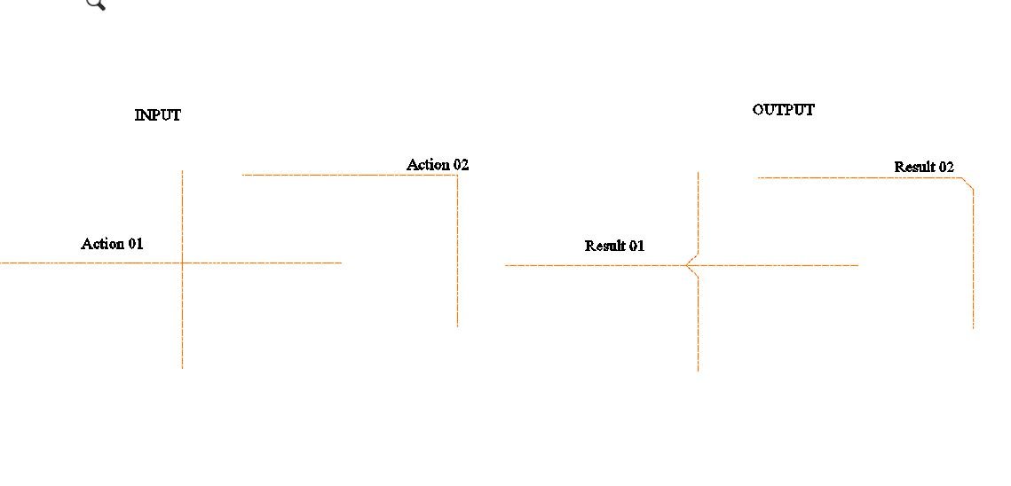

01.automatic chamfer on ortho polyline corners in (Screen Short result 01)
02.And automatic 45 dgr double polylines on intersection polylines. (Screen Short result 02)
2 seperate functions.
1. Pick object1 pick object2 do a chamfer not hard to do as a lisp with say pre set cham
fer
2. Pick object1 pick object2, more complicated break object2 at intersection of object1, draw 2 new lines, if pline add into original.

Hai Bigal
Thank you for your replay..
i m doing the same... if some one help me to bypass those steps with lisp ... it may make me more faster.
looking for,
auto chamfer on 90dgr corners.
and auto twin 45dgr on intersections.
hope it is possible with lisp.
Edited by RIA
You still need somehow to pick what you want done the chamfer maybe 2 lines look for 2 matching xyz points and chamfer.
The 45 jump over you have to say which one some how.

Thank you guys... with the above i can make only arcs.. any chance to make as mentioned in screen short?
i mean 45 dgr lines ?
The hop works via a pick point the issue is you need to pick twice, first the object and second pick is where, to place the ^
The code has this which is the left and right point of the hop so need to add a 3rd vertex using this method.
(vlax-invoke o 'addvertex i (mapcar '+ p1 '(0 0)))
(vlax-invoke o 'addvertex i p3)
(vlax-invoke o 'addvertex i (mapcar '+ p2 '(0 0)))
So need to work out p3 it needs angle p1 p2 and a polar.
A modify of hop is needed for the pick twice, hence I was suggesting drag over the 2 objects.
(setq p (vlax-curve-getclosestpointto (car e) (getpoint "\nPick V point"))
It would make sense for say ronjonp to maybe add the ^  as an option. PM him.

this is coming..  Whose code are you running ?
Try this based on ronjonp codeMulti radio buttons.lsp
https://www.cadtutor.net/forum/topic/73466-can-anyone-help-me-to-make-a-lisp-to-make-below-action/
(defun c:hop (/ a d e i o p p1 p2 p3 oldsnap)
Command: HOP
Pick a line or polyline to add a hop Enter to exit:
Pick the intersection point; error: LOAD failed: "Multi Radio buttons.lsp"
Click on the MULTI RADIO BUTTONS.lsp icon in the post above to download it is a library routine used in any code.  Or go to DOWNLOADS, there is Multi radio buttons, getval, toggles. I do have more.
