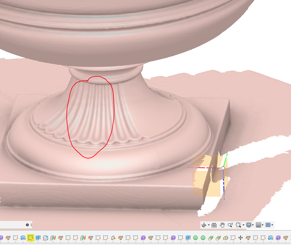

I've been asked to model the attached urn and am struggling getting some of the features attached.
Any ideas? I have fusion 360, inventor, Autocad and rhino at my disposal.
image.thumb.png.c698e6cfccc8d5ee9305ad980d8903b6.pngimage.png.4f25d8f06768de4a6873a815149d36fb.pngimage.png.6259bc0632342cf44f1dd31ba980a05c.png
Break those radial elements down to a single unit, of an appropriate dimension, then use polar array in Top view to copy them around your centerpoint.
Use the Fillet command to apply the radius as indicated by the black spots.
Once you have everything modeled you can use the Union command in Autocad.
I have not used Fusion, Rhino nor Inventor enough to help using them, although they are likely better choices than using Autocad
