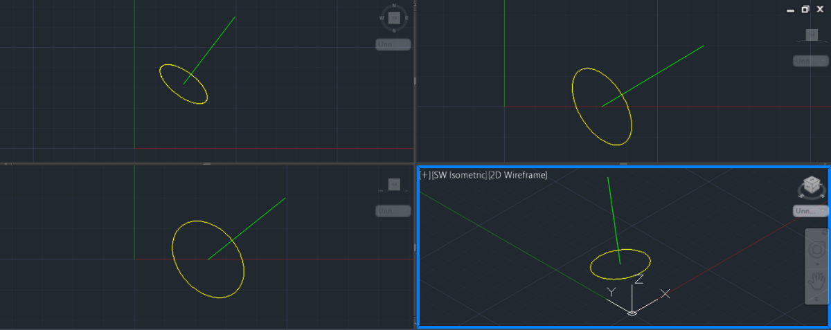

I am trying to do a lisp routine  where I click on two points.  The center of the circle is on the first point and has a fixed radius or diameter.  The circle has as its axis an imaginary line between the two points.
Getting the two points is easy enough, but how do I orient the circle along the imaginary line?  The two points will be typically non-orthagonal (I don't know if that makes a difference though).

Should "The circle has as its axis an imaginary line between the two points" be interpreted to mean that the circle lies on a plane perpendicular to the line defined by the two points?

Yes.  I should have been more clear, but that is it exactly.

Here is a 4-view that is an "after".  Upper left is top.  Upper right is right, lower left is front, and lower right is isometric 1.  The green line represents two points.

Like this?

6 hours ago, Jonathan Handojo said:

Thank you Jonathan Handojo!  That is what I was shooting for!  I need to study the Unit Vector by Lee Mac to see if I can get an understanding of how this works.  Truly amazing solve and I appreciate it!
Greg
The Cal function NOR may be useful, "Calculating a Normal Vector", nor(p1,p2)
