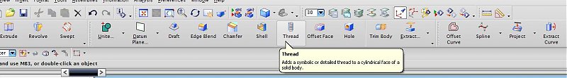

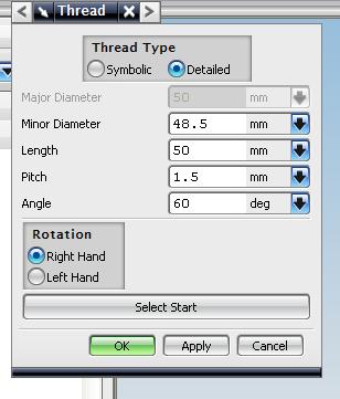

shift1313 Posted February 13, 2009 Posted February 13, 2009 bl, i would be careful about putting your phone numbers and email in your sig. you never know who may get a hold of it:) this is one thing i really like about unigraphics. When you create threads it actually creates threads. Quote

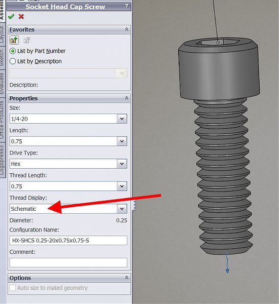

cedar Posted February 14, 2009 Posted February 14, 2009 Fasteners in Toolbox have the option to show true thread. Solidworks promotes its programming as being customer driven. If customers asked for a thread command they would have made a thread command. I personally design a million dollars of tooling every year and never model threads unless it’s special… and that’s rare. I imagine most others are the same. When I see a true thread of a common screw on a print… I think it’s a vain attempt to be impressive. Thread engineering was perfected 80 years ago. Quote

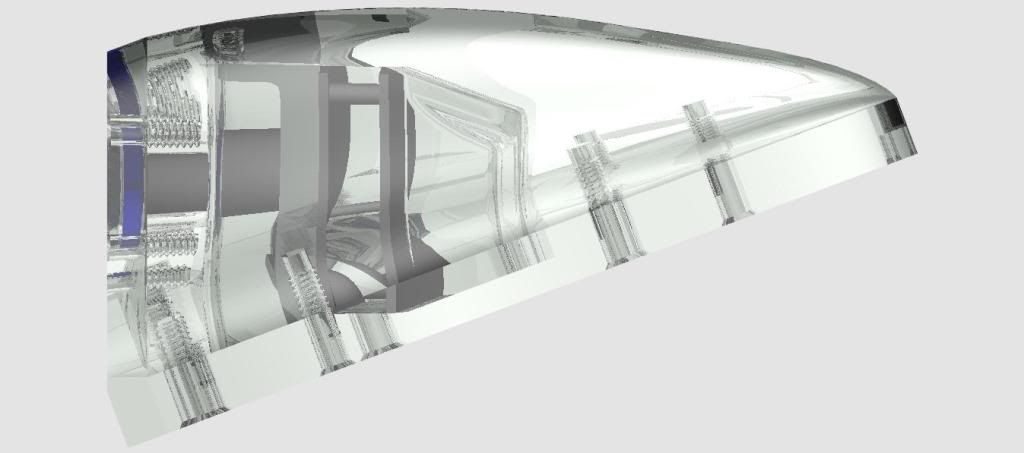

shift1313 Posted February 15, 2009 Posted February 15, 2009 i would agree cedar. I will usually throw threads in for renders and things. the drawing i posted actually was 3d printed with the threaded holes. It is rare, but i like the fact that in UG or SW you can suppress the threads:D Quote

shift1313 Posted February 17, 2009 Posted February 17, 2009 Having threads is very useful but being able to turn them off, especially with large models is even more useful:) In ugs, there is a thread button as well as a "toolbox" to load components. The thread button is a really nice feature that i wish SW had in certain instances. Quote
