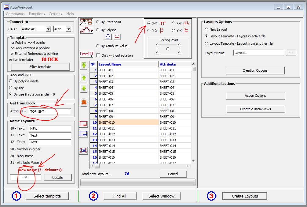

@maratovich I think what your software will do is create a layout from the exisitng viewframe. what Im trying to achieve is to create a viewframe on the model space along the Polyline. I already have a lisp routine that will create a multiple layout from given viewframe.
Edited by benzson11
1. I gave you a picture of an example - you did the opposite with different settings.
2. There are video tutorials - you need to watch.
Why did you choose "20"? Default Auto ...
Didn't select Template ...
You dont need a block just a rectang of the correct size based on your final plot scale for a titleblock. Using a repeat function that works out the spacing. Including how much to overlap. Happy to provide for a donation. Or look at measure and divide using a block.
