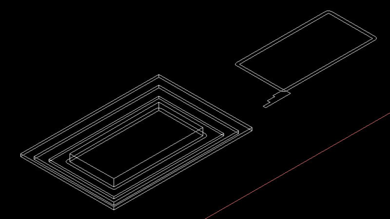

I have a basic routine which will draw the cross section of a generic pond. How would I get a volume to show for the top of bank and the normal pool? I found a routine that can calculate a volume, just having trouble how to plug it in.  Then again, I might be doing this all wrong. Maybe I would type the desired volume and it would project the top line down to create a bottom for that volume.
The idea was to quickly get an idea of a volume if it would fit in a given area. Thank you for the help.

Another way is draw the 1 side in elevation, use rotate3d stand it up vertical use extrude path. so it makes the edge shape all round, note the path should be at the alignment of the bottom ie meet at centre pt of cnr radius, then add a rectang and extrude, union and that is volume, you can do sloping surface and subtract etc also.
The obvious though is do in CIV3D etc.
A roughy needs a 1mm rad

Thank you guys for your feedback.
I found another way to do this from the post below.
https://www.cadtutor.net/forum/topic/64976-selection-of-contours-automatically/
This works great with Polylines but i can figure out how to pull the elevation z from the feature line without exploding and converting the feature line from a 3d Poly to a 2D poly.
Is there another way to look at this? thank you!

Are you working on Civil 3D? Because it calculates quantities, there is no reason to use Lisp Please include an example drawing
Here's one for fun .. reports volume between each elevation change then a total:

Thank you. I like the idea of this.
As for Civil3D, you are right "creating a bounded volume' can create the number. I was looking for something more quicker to get a rough result rather than adding feature lines or polylines to surfaces, etc.
