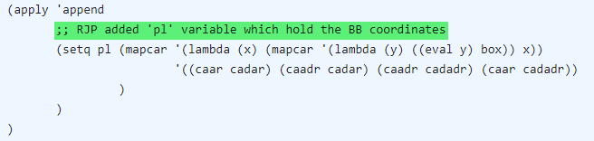

Hi,
I am new to this forum and I am also new to autolisp. Over the weekend I managed to use Lee Mac's Selection Set Bounding Box function and customize it to my needs. However, the way I did it is fairly clunky and not elegant at all. What I need to do is create the bounding box, then I need to erase the original selection. After that, I need to move the empty rectangle's lower left corner to 0,0,0. Finally, I need to move everything to layer 0 and purge everything else.
I managed to do it through a move all and using EXTMIN's value as my first displacement point. However, as I discovered, EXTMIN can be very unreliable because it varies whenever you zoom your drawing or change from model space to layout. So I added a zoom _e command in the program and redo my move all a second time. So far, it works well but I know Lee's code already generates a list with the coordinates of the lower left corner and upper right corner so I would like to use that list instead EXTMIN. I just don't know how to call that list because his code is a bit too complicated for my skill level at the moment. I can see that ls1 is the one with the lower left corner coordinates but I don't know how to use it. I added all the commands at the bottom. Please don't judge haha I'm very much a beginner. Any help is greatly appreciated.

Give this a try. What is the need for doing this?

			      ;; RJP added 'pl' variable which hold the BB coordinates
			      (setq pl (mapcar '(lambda (x) (mapcar '(lambda (y) ((eval y) box)) x))

Thank you Ron for your reply.
I tried your line of code and it seems to be working.
(command "_.move" "_all" "" (car pl) '(0 0 0))
However, I fail to understand what "car pl" does. I understand what car does, but what's pl?
As for the double move, as I said in my original post, I use EXTMIN's value to move to 0,0,0 but extmin is very unreliable and is tied to your zoom extent. Often, it would be off of 0,0,0 by a significant chunk. The way to resolve this is to zoom your drawing after a first, unprecise move and then move it again. After a second move it seems to be always spot on. But like I said, it's super clunky so that's precisely what I wanted to remove from my code. Not having to move my drawing twice or to zoom in on it.

I commented in the code about that :)
Oh I see. I did not notice your comment. It all makes sense now. I really didn't know what that part of the code was for. I could see there were some X Y coordinates being set but the whole caar cadar stuff I really can't follow. Knowing what it is now, I understand your modification to the code. I guess I incorrectly assumed that you could use variables or lists used in the function so I was fixated on that.
