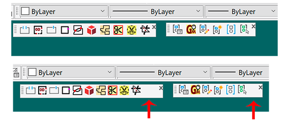

Strange thing happening with my toolbars, placed as floating on desktop in my Autocad 2022.
An empty space appeared at the right side of toolbar, usualy one or two icon size.
After restarting Autocad , everything is normal, but after a few minutes, it shows again.
Any idea why is that?
I have seen something similar before, and found one reason for it happening.
But note that this was in 2008, with AutoCad 2002 LT running on Windows XP, so I'm not sure if it's much help apart from pointing to possible causes.
Back then it was changing the Printer Setup in Windows when AutoCad was open that for some reason gave the extra space(s) on some but not all AutoCad toolbars.
It only affected the toolbars with 7 or more buttons.
Weird right? And difficult to track down, I only found it by luck.
Are you by any chance changing your printer setup in Windows when AutoCad is open?
Here is the old thread (on a different forum) from back then:
https://www.cadeverything.com/help/showthread.php/2577-Extra-space-for-buttons-on-toolbars?
