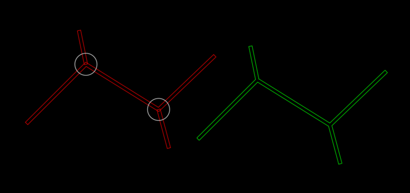

LISP for closed boundary with offset around polyline
can anybody provide me the lisp for generating closed polyline boundary at an specified offset around the network of polylines as shown?
(the actual set of polylines is very complex so i need a help please)
thanks for the reply, but i already had those lisp, it gives me following output as shown is red, but i need only one outer closed boundary as shown in green, can you please help me with that? These are just couple of polylines, my actual network is really complex, ( example : just like centerlines of all the roads nearby your area where you live)
Now you just need to use Lee-Mac's Outline Object lisp and your task will be complete.
i did that exactly but my network is fairly complex it is causing problems by this method. im attaching file here, can you please go through and check for yourself once?

Something I have been playing with, one way to union all the offsets is to do just that, then extrude all plines say 5, union the plines this will clean them up and do all the intersections, you explode the solids so get regions need to remove all regions that are not Z=zero, so then erase ss, only thing is you will be left with lines.
Try this, worked on sample I need to add remove duplicates tomorrow. Also I am sure speed can be way better.

JUST TRIED THIS. IT WORKS FOR SINGLE PLINE SEGMENT.  PLEASE SEE IF IT CAN CREATE CLOSED OUTER BOUNDARY FOR ENTIRE NETWORK, MEAN WHILE IM ALSO SEACHING IF I CAN FIND ANY ALTERNATE SOLUTION. THANK YOU.
5 hours ago, zwonko said:
Did You tryied this one after polyout? http://www.lee-mac.com/outlineobjects.html
IT is what eldon is saying about.
Of course, there are more "elegant" solutions by using VLisp, but here I used some of BIGAL's code and got the attached drawing.
So, try this:

Here's another output using Lee's advanced outline along with overkill region and union ( similar to above ).
OUTPUT-rjp.dwg
Edited by ronjonp
"OFFPOL" WORKED LIKE A CHARM, THAT IS EXACTLY WHAT I NEEDED,
THANK YOU FOR YOUR EFFORTS AND TIME. YOU GUYS ARE AWESOME. (ELDON, BIGAL, ZWONKO, LIDO, RONJONP)
