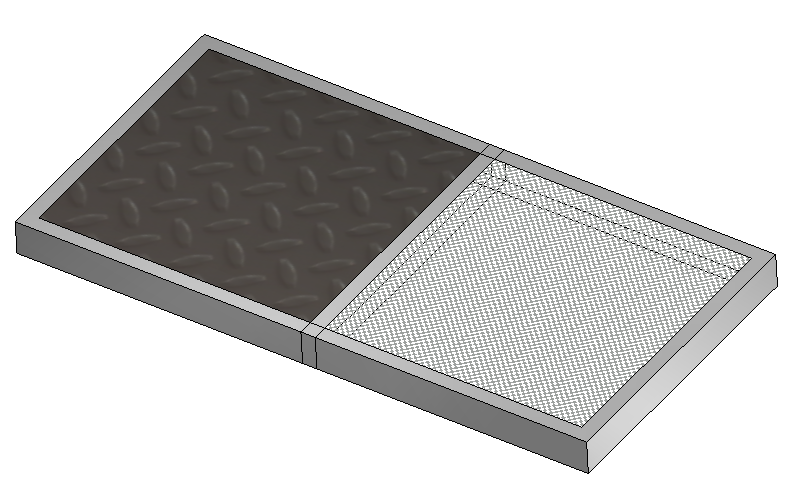

JD Mather Posted February 11, 2009 Posted February 11, 2009 The part I posted should have had two texture samples - a diamond plate texture and an expanded metal texture. I don't know anyone who actually goes to the trouble of modeling these. A cosmetic texture should be fine by the time you zoom out to include the assembly - no one will be able to tell the difference. Quote

JD Mather Posted February 11, 2009 Posted February 11, 2009 Here is a screen capture. The texture of the expanded metal screen even allows you to see through the part and see other parts behind the plate. (not included in this image) You can apply textures by part, by feature or by individual faces. If a desired texture is not already in Inventor, you can create your own texures (or download from cbliss.com - have to look around a bit to find them on that site) Quote
Hberg29 Posted February 11, 2009 Author Posted February 11, 2009 What setting controls weather or not you can view those textures in your assembly drawing? I can apply those textures, their loaded in Inventor but If I change them (apply them to a part) It looks the same and I can't see that texture on the actual part? Quote
JD Mather Posted February 11, 2009 Posted February 11, 2009 ... textures in your assembly drawing? ... I can't see that texture on the actual part? Are you trying to apply at assembly level or part level? See #94 & 95 http://home.pct.edu/~jmather/AU2006/MA13-3%20Mather.pdf Attach your file here if you can't figure it out. Quote
