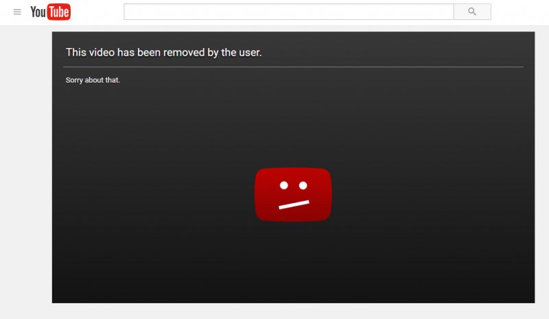

Why did you post a link to the video and then remove the video? :unsure:
Also, you replied to a question from nearly 9 years ago. Please don't dig up old posts just to promote your lisp routine.
