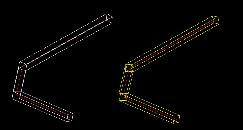

[REQUEST] offsetting 3dpoly autolisp OR drawing 2 parallel 3Dpoly at the same time (like MLine)
Hello everyone. Im using AutoCad 2021 and sometimes older versions of AutoCad but nothing before 2016.
I often draw 3dpoly lines and im trying to make an effort using Sweep command to make that 3dpoly appear as a square tunnel.
The issue is when the object twists as there are arcs or angles around the path.
I wish to keep the rectangle shape of the tunnel straight and I saw an option of using Loft comand but i need atleast 2 lines to make a surface which brings me to my request.
ofcourse this problem doesnt occur with circles, but only in shapes that u can see twist.
I do have a lisp for offsetting a 3dpoly but it doesnt work good on a 3dpoly that turns around itself (as in the file attached, blue line is the resulted offset i tried).
what happens when i try is that the line gets cut off and split to smaller lines that arent paralel to the line i tried to offset
What i would wish for is like the double offset lisp made by lee mac but for 3dpoly, to make it offset on given range.
EDIT: maybe is there a known lisp to do something like MLine with a 3Dpoly?
test.dwg
do u guys have any idea or a lisp to get this done right?

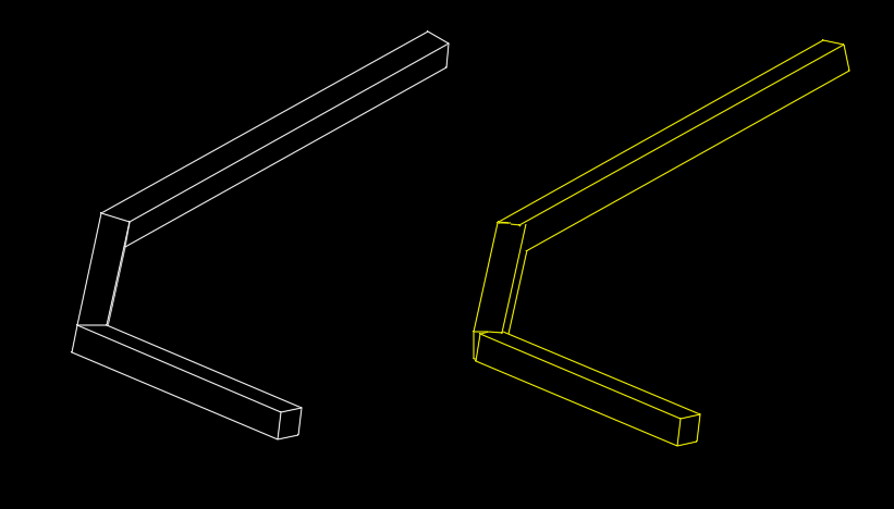

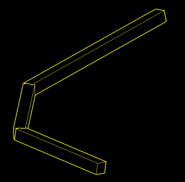

 How do you define zero twist? Is your goal to keep two of the side of the square profile parallel to the world XY plane?  In the image below the red line is a 3DPOLY that has vertices of changing x, y, and z coordinates. The white shape used sweep and a square.  The yellow shape has its square cross sections with two side always parallel to the XY plane.  It was constructed by position boxes end to end with rotations about axes parallel to the XY plane.
After unioning the boxes together it looks like this.
Is this what you want?

Thx for the asnwer. It seems good but I do not understand how to create the box on the 3dpoly like u did. is there a chance u can elaborate or refer me to a tutorial?

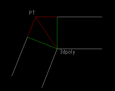

I think need to explode and offset, then work out the new IP point and reset the 2 end points, as you can not fillet, then join ?
Now where is my sin cos. Ah yeah pt Z changes must do second sin cos.
