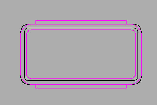

I have never had the opportunity to work with a Tekla Export file before, so I had a look and have a few comments.
Overkill reduced the overlapping lines. The shapes are not exactly equal, and the Tekla corner radii seem to be made of straight lines with an arc!!
It must be the translation process that produces these oddities. So, forewarned is forearmed and run overkill on any future files.
I see also that all the lineweights are 0.00.
Must be the translation process that produces a pseudo AutoCAD drawing!!
