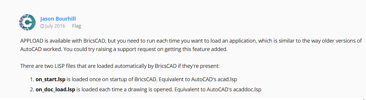

BIGAL Posted October 21, 2021 Posted October 21, 2021 (edited) 1st thing contact Drafsight if there like Bricscad they will get back to you very quickly. This is some comments about Bricscad, I am sure similar for Drafsight, there should be a Drafsight forum I would also ask there. Current Bricscad versions have a autoload option. Just another thought in the desktop icon there is the command line that does the work, under properties, in the case of Autocad there is the ability to add a run script on startup "/S mystartupscript" this scr could have (load "myautoload.lsp") as the script. You just copy and paste the icon if you want to try so keep original. Edited October 21, 2021 by BIGAL Quote
