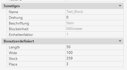

Fill CSV file with block attributes

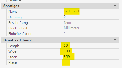

Hi all, I'm looking for a lisp that will write the custom content from the block attributes of a specific block (in this case named "Test_Block") in a CSV File.
In the image below, you can see in red the fields that are the same every time, and in green, the variable values I want to select from the block.
Does anyone have a template or idea how this should work?

Hi, DWG test_door_block.dwg and CSV attached.
In the CSV file I have filled the cells in red, which must always be written, and in green the variable numbers, which should be selected from the block.
Do you have any idea how this could be done?
Thanks in advance.

2 hours ago, BIGAL said:
They are dynamic blocks in your sample so this matches your sample, it can be changed to work with any dynamic blocks.
The lisp works very well!
The attributes are all written in one line. How can I tell that an attribute goes in a specific row (e.g. cell B2)?
Just open the csv with Excel it will auto column, if you use the semi-colon for seperator change the "," to ";" different parts of the world use , v's ; inside Excel.
