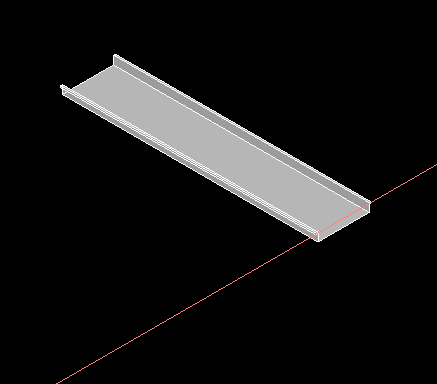

3d objects are possible and there are various ways of creating. You need to provide some samples.
Check out cable tray by Tharwat.
