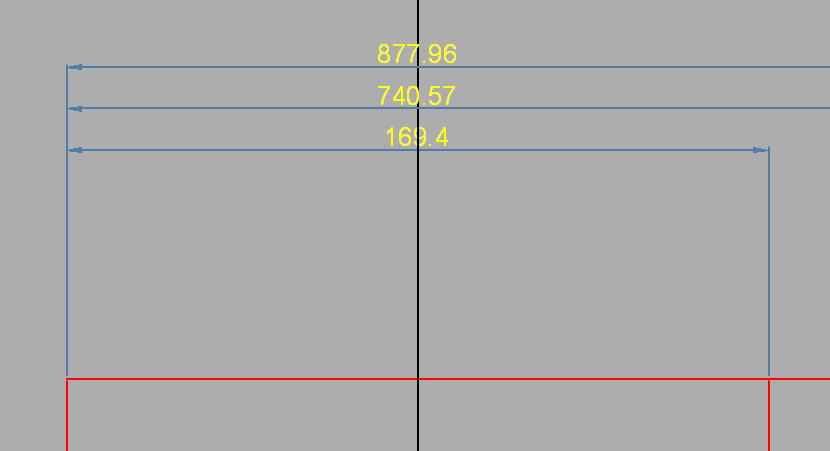

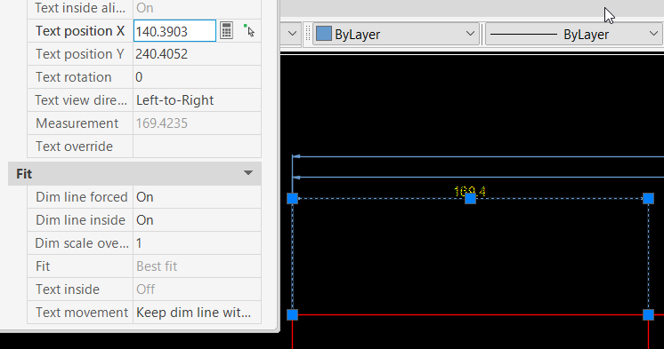

francine2013 Posted November 4, 2021 Posted November 4, 2021 Hello, I'm looking to find a way to align multiple dimension text. The reason is that I'm using the Viewport and some dimensions are invisible. Attached are a drawing explaining what I'm looking for. Actually I manually copied the coordinates in the properties and inserted them in the dimensions I wanted to change. Is it possible, by using the text position X or Y coordinate, to modify by lisp the other dimensions? Can somebody help me please. Many thank Dimension.dwg Quote
eldon Posted November 4, 2021 Posted November 4, 2021 If you don't mind drawing a temporary line, you can line them up very quickly. I drew a vertical Xline through the Insertion point of the dimension that is in the right place. Then click on the other dims and drag them so that they are Perpendicular to the Xline. Then erase the Xline. Quote

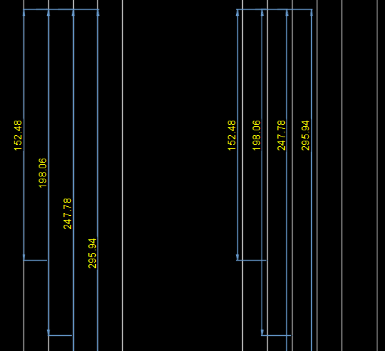

francine2013 Posted November 17, 2021 Author Posted November 17, 2021 Using Giles' lisp I noticed that the dimension lines also change place, which doesn't suit me too well. (see attache image) Is there a solution so that the lisp doesn't do this? (see attached lisp) DAT.lsp Quote
