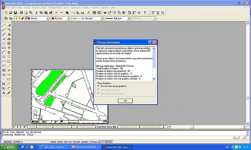

antonydrew Posted February 12, 2009 Posted February 12, 2009 good morning we have a file that is very slow regenerating between layouts and the model, especially when two of the layers are on. they contain multiple blocks totalling about 10000 metres of pipes on a drawing of an airfeild. the file is about 4.0MB big and is slow to load also. I do not want to post the file here, but will mail to you if you think you can help me regards Quote
ReMark Posted February 12, 2009 Posted February 12, 2009 Have you run a purge on the file? What are the specs of the computer (OS, RAM, and graphics card)? Quote
antonydrew Posted February 12, 2009 Author Posted February 12, 2009 yes, i have run PURGE and AUDIT no errors found Dell DE051 2048 MB Memory Version 5.1.2600 Service Pack 3 Build 2600 Name Intel® 82865G Graphics Controller PNP Device ID PCI\VEN_8086&DEV_2572&SUBSYS_01D51028&REV_02\3&172E68DD&0&10 Adapter Type Intel® 82865G Graphics Controller, Intel Corporation compatible Adapter Description Intel® 82865G Graphics Controller Adapter RAM 96.00 MB (100,663,296 bytes) Installed Drivers ialmrnt5.dll Driver Version 6.14.10.4396 INF File oem13.inf (i865G section) Does this help Quote
ReMark Posted February 12, 2009 Posted February 12, 2009 My advice would be to buy or build a serious CAD computer. The Dell DE051 uses a Celeron D processor with integrated graphics. It maxes out with just 2GB of DDR2 RAM. The CPU is stealing resources from the system RAM to run the display. This would probably explain the reason for the slow regens. Are there any Xrefs loading with this drawing? What OS are you running? XP? If so, what version? I can think of other reasons for slow performance but your hardware setup is probably the main culprit here. Quote
antonydrew Posted February 12, 2009 Author Posted February 12, 2009 Hi XP Version 5.1.2600 Service Pack 3 Build 2600 i ran the task manager when the regen was happening and it was using 531000k during the regen. Not sure about xternal references tho as i have not created this drawing it was sent to me to edit. I can mail you a copy if you want, but as it is not my drawing i dont really want to post on the site. cheers Quote
antonydrew Posted February 12, 2009 Author Posted February 12, 2009 Sir have just located the original file which is 9.61MB and runs pretty well on my machine....it has many layouts, which are not used in the version i am using so have been deleted. i have looked in the xref manager and there are no external refernces threre. Also when opening there is a dialog box warning about proxy information...I have included a screen shot for you Quote
ReMark Posted February 12, 2009 Posted February 12, 2009 Re: proxy objects. http://katescadtips.blogspot.com/2007/09/proxy-objects.html Quote
ReMark Posted February 12, 2009 Posted February 12, 2009 From AutoDesk re: object enablers. http://usa.autodesk.com/adsk/servlet/index?siteID=123112&id=2753223&linkID=9240618 Quote
