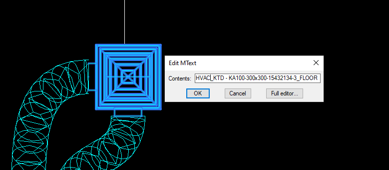

I have hundreds of blocks in my Autocad project. Let me give an example; Ventilation grills are named differently for each floor. Normal projects will have labels next to the grills, but not in this project. But inside the blocks, the dimensions of the culverts are written. I can count the names of the blocks with "bcount", but I cannot check their accuracy. For this reason, I want to proceed in a controlled way by printing the names of the blocks. You can see an example block naming in the picture below.
I tried the lispi you sent, but it gave the following error; "error: malformed list on input"
This is what i use.
;; LABLE BLOCKS BY NAME MIDPOINT OF BOUNDINB BOX
  (defun C:BLKNAME (/ SS e Name LL UR MPT)
    (if (setq SS (ssget '((0 . "INSERT"))))
      (foreach e (vl-remove-if 'listp (mapcar 'cadr (ssnamex SS)))
        (setq Name (cdr (assoc 2 (entget e))))
        (vla-getboundingbox (vlax-ename->vla-object e) 'minpt 'maxpt)
        (setq LL (vlax-safearray->list minpt)
              UR (vlax-safearray->list maxpt)
              MPT (polar LL (angle LL UR) (/ (distance LL UR) 2))
        (vl-cmdf "_.Text" "J" "MC" MPT "0.250" "0" Name)
      (prompt "\nNo Blocks Selected")
add the following if you need diffrent text sizes
(setq txtsz (getreal "\nEnter text size"))
(vl-cmdf "_.Text" "J" "MC" MPT txtsz "0" Name)
Mhupp thank you lisp works very well. Exactly like I want. When I add the code you gave for text size and run it, I have to write the size value for each block one by one. Is it okay if it asks once at the beginning of the command?
