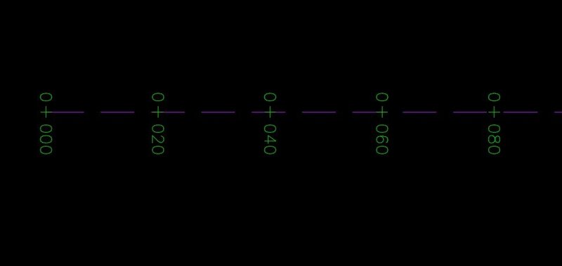

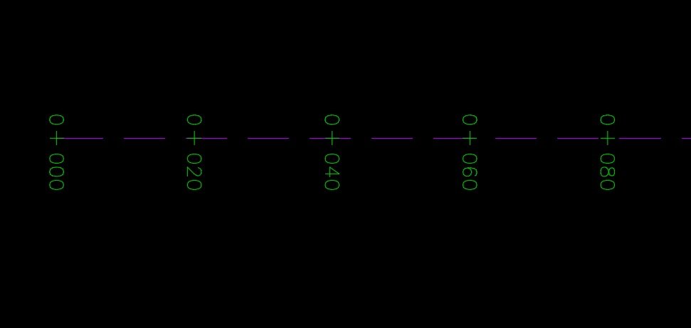

I have a 2D polyline approx 4,000 meters in length that needs to be stationed every 20m (0+000, 0+020, 1+020, 1+040, etc.).
In the past I would use array to place the labels every 20m then use an incremental text lisp to change the labels but it requires me to select each label as I go along the alignment.
Is there a way in Civil 3D to station a 2D polyline like the attached example?
Thanks

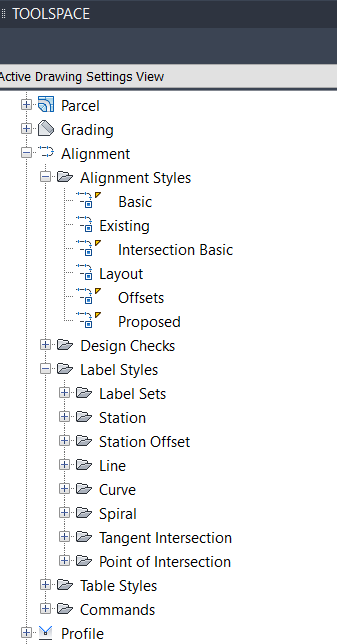

Like SLW210 google the help CIV3D labelling an alignment, its about using an Alignment style.
To use alignment labels, you have to create an alignment first. Let us know if you need help with that.
