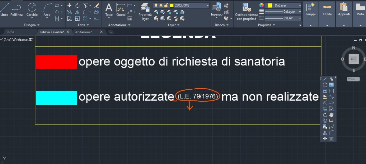

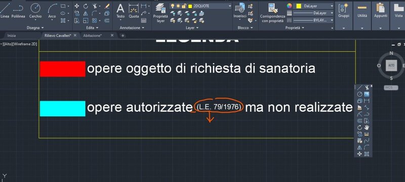

How do you proceed to lower this part of the writing that has been reduced? Thanks

Hard to say without having an example drawing. Is this MText? Text? Individual Text Object?
My WAG is it is MText and what you want to change is Superscript, if so, open it in the editor and deselect Superscript, but not sure if 2010 AutoCAD has that, but looks like you have a newer version.
There are some Strip Text Formatting LISPs around.

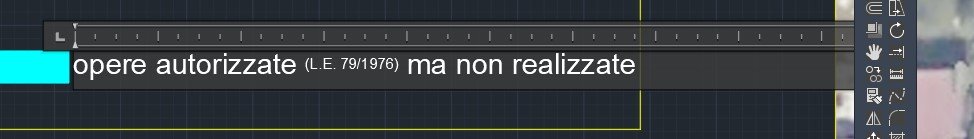

I click on the text and you only see the ruler, I use autocad 2021, what is the command to lower the small text? Thank you
You do not say how much you want to lower it by.

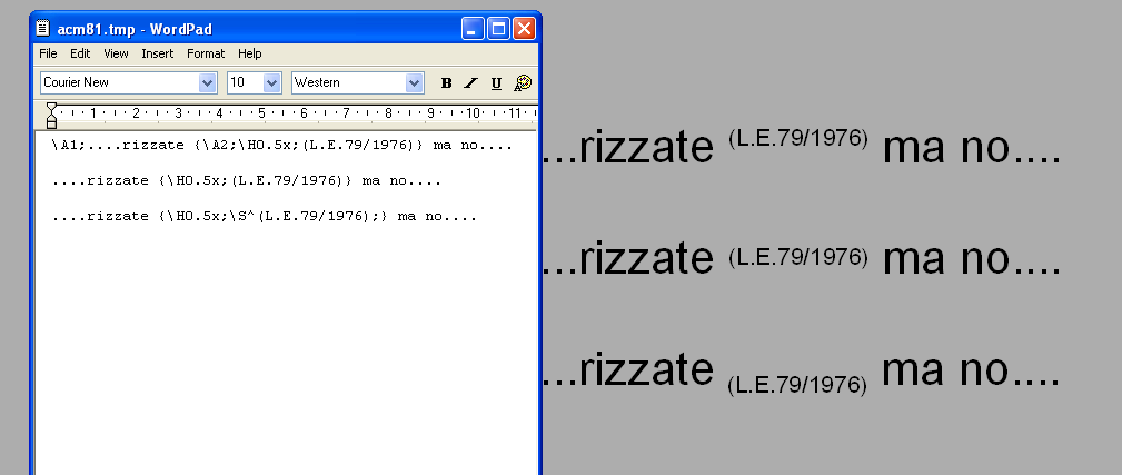

But you have to change the Mtext editor to something like Notepad or Wordpad, and then you can see the formatting.
Or you could highlight the relevant text, and then right click to see what options you have available

In the Mtext Text Formatting box, just deselect the X² after highlighting the Superscript.
