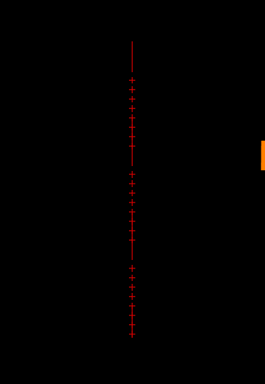

I'm having problems just creating a + symbol line type. I can have four pluses come up, but then a line comes up between them. I want all + signs. No spaces or dashes.
Any tips on this?
I just need pluses. Super frustrating.

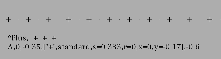

Yes, but no dots between. Just the plus symbols.
The AutoCAD linetype definition HAS to have a line at the beginning of the definition. A dot is the smallest line possible.
Ahhh...I see. Well, it is what it is.

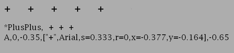

If you have a TTF font in the TextStyle and adjust the position of the text, you can hide some of the dots.
and changing that A to an S gets rid of the lines at the ends.
*PlusPlus, + + + + +
S,0,-.35,["+",Arial,s=.333,x=-.377,y=-.164],-.65
