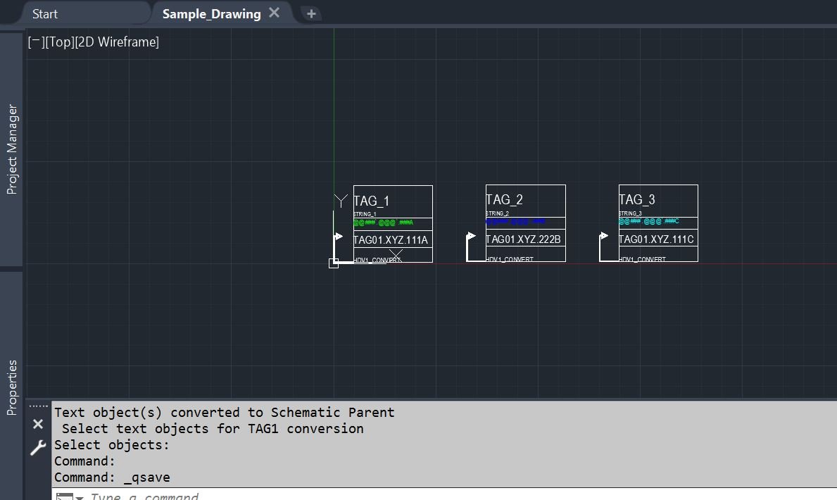

hello everyone,
I'd like to share an idea based on the Leemac script (Escape Wildcards).
is working fine, but I would like help for code optimization.
1: Searches the text according to the wildcard setting
2: selects all texts found
3: If the wildcard is found, it creates the layer and changes the blocks to its layers.
4: Sets the color of the layer
5: converts to block (HDV1_CONVERT)

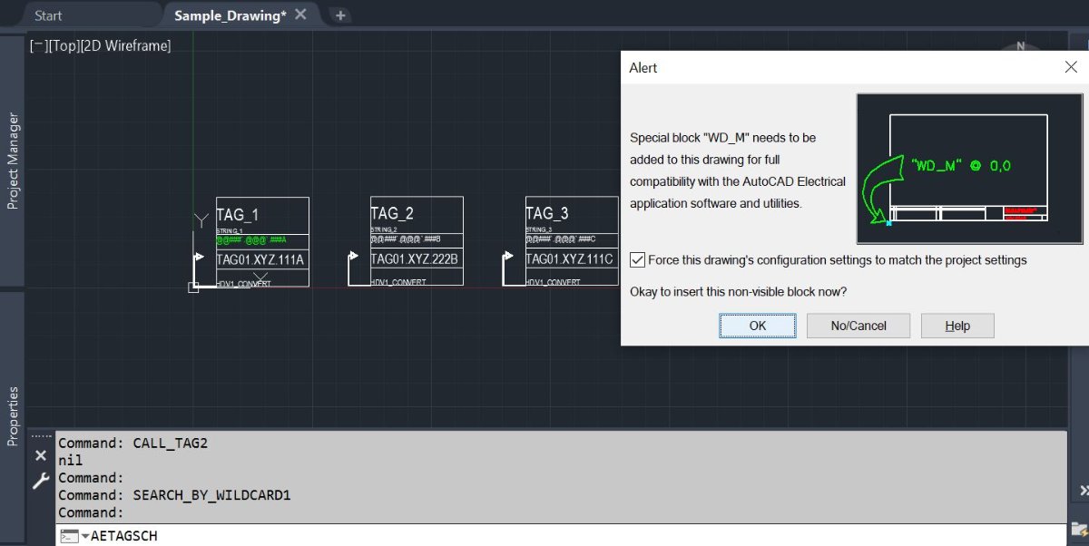

As you can see in the attachment, when I run the script for the first time, the alert appears.
Is there any way to accept the alert automatically?
Regards

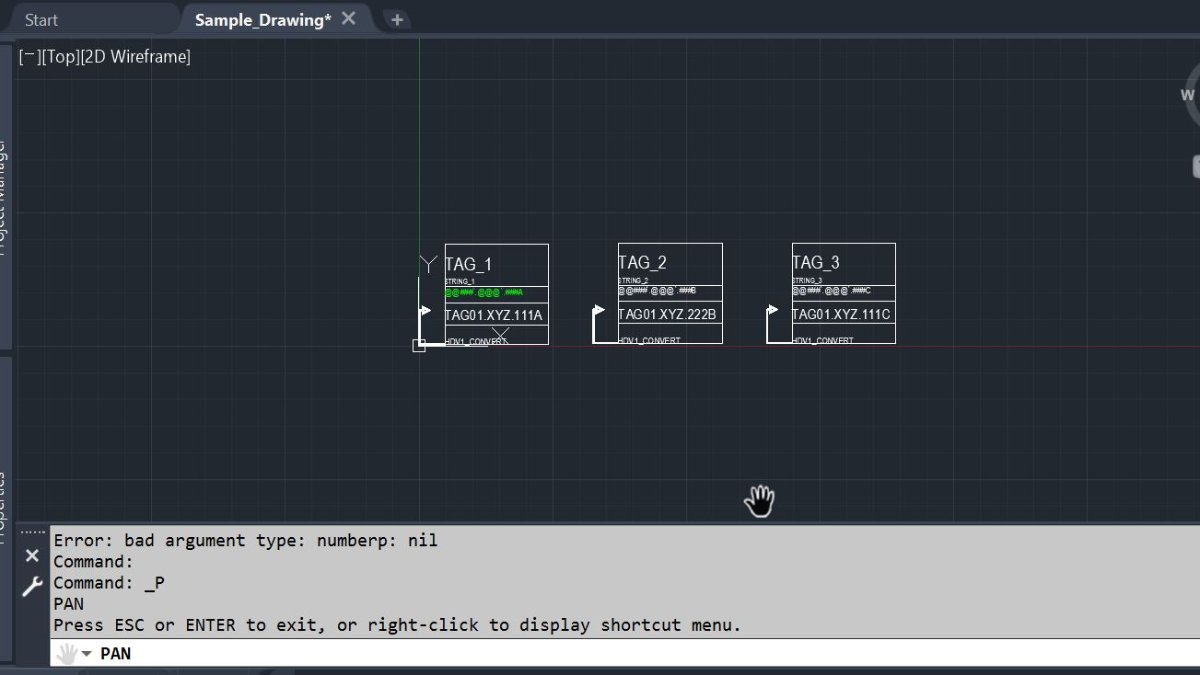

"Bad argument type: numberp: nil' usually comes about because the code is expecting a number and often has been given a string to use (it doesn't like adding "e + t" but can do "3 + 7' OK.  Not quite as simple as that, on the screen you might see the contents of a variable as a number, but those contents might have been defined as a  string... and LISP cannot do arithmetic with strings. It can also return the same error if it is trying to process an empty variable, or a value of nil
You have a couple of functions that can run directly from the command line, which one do you use to run your functions and which cause the error?
You have quite a bit of code there to look through and my CAD is off till next year, but to get you going how much debugging have you done so far? can you identify sort of the area in the code where the error occurs?
So.... assuming that a lot of people are having a Christmas and New Year break if you can narrow things down then it will be quicker for them to help. I would normally comment out all the code  (use a ; - or a multiple of them so you can spot quickly which you have commented out temporarily), and then put the lines back in, few at a time... and this is where the indents help so for example, you can put back in an 'if' command and spot its closing bracket to put that back again. So then run the code, out lines back in and run again until you find the line giving an error  Use princ to return to the command line contents of variables to see if they are what you expect
That is how I would go... there might be better ways to go about it
