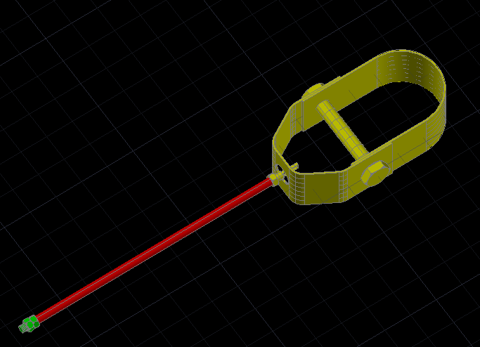

Eric_M Posted December 28, 2021 Posted December 28, 2021 Hi. I hope I put this in the right category! I am trying to create a pipe hanger with a variable length rod hanger. But if I use the stretch action for a dynamic block it just moves the rod. I tried the scale command but don't see how to just have the length stretch and not have it affect the diameter. (file is attached) Thanks! Clevis_Models.dwg Quote

lrm Posted December 30, 2021 Posted December 30, 2021 One approach may to consider the hanger as three parts, a block for the top (yellow), a block for the bottom (green) and a cylinder (red). A simple vlisp program could place the two blocks and create the cylinder from 3 points (2 for the end ponts and one for the orientation) or some similar input. How do you usually specify the location of a hanger? Quote

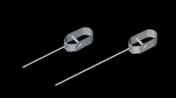

steven-g Posted December 31, 2021 Posted December 31, 2021 Try this version, I just made a copy of the rod and used an 'array' on the copy which gives it the appearance of stretching. You may see a tiny gap every so often in the rod, I set the array distance to as close as possible to the length of the rod 4 71/128" (but that isn't the exact size) I'm more used to using metric sizes and being an LT user I don't have the commands available to edit the solid to a more user friendly length. Hopefully this will get you started though. Clevis_Models(1).dwg Quote
BIGAL Posted January 2, 2022 Posted January 2, 2022 (edited) Looking on a another forum there may be a way of changing rod length and its pretty straight forward. Solidedit Face Extrude choose top circle/face of rod then Enter and enter a change value. So if 100 now enter 100 will be 200, enter -25 will be 75 long. Ok now the tricky bit pick the top of the rod ? Hmm (1 . "plane-surface $-1 -1 $-1 0 0 200 0 0 1 1 0 0 forward_v I I I I #") is it top Added 4 to rod but its not a block anymore. Edited January 2, 2022 by BIGAL Quote
