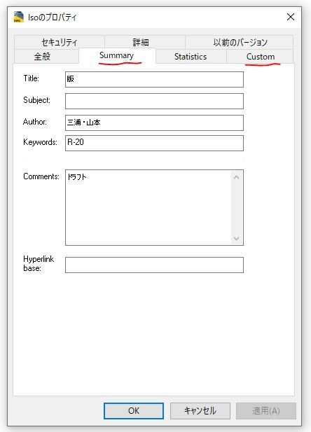

1:Dwgprops
By default at my office, the property tabs (Summary, Custom...) of Dwg file are not displayed.
I read somewhere the solution to this problem:
Dwg file:Right mouse/ openwith/ select Apps ''AcLauncher''
Link:C:\Program Files\Common Files\Autodesk Shared\AcShellEx
Problem: view only, not editable in WE.
Does anyone know how to edit directly at WE?

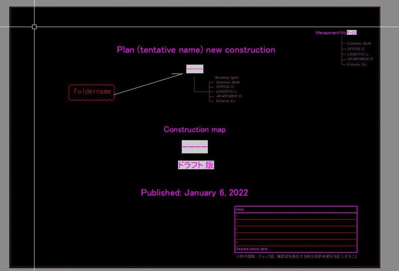

2:Diesel expression path filename
I am working on a Complex project ([A]partment, [O]ffice, [L]ogistic building).
The drawings are located in the respective folders (Apartment, Office, Logistic)*.
I want to get the Fields value of the Folder* name in some of the contents of the drawing cover title Layout. Example: Apartment Plan Project...
Opt1: I'm using
$(SUBSTR,$(GETVAR,dwgprefix),No.1,No.2)
Because the names of the Folders have different character lengths, No.2 cannot be applied to all 3 folders
Opt2:
$(SUBSTR,$(GETVAR,dwgprefix),No.1,$(-,$(STRLEN,$(GETVAR,dwgprefix)),No.2))
Because the project folders include many branch folders, No.2 cannot be applied to many drawings.
Is there any way to get Foler's name (with different character length)!?
