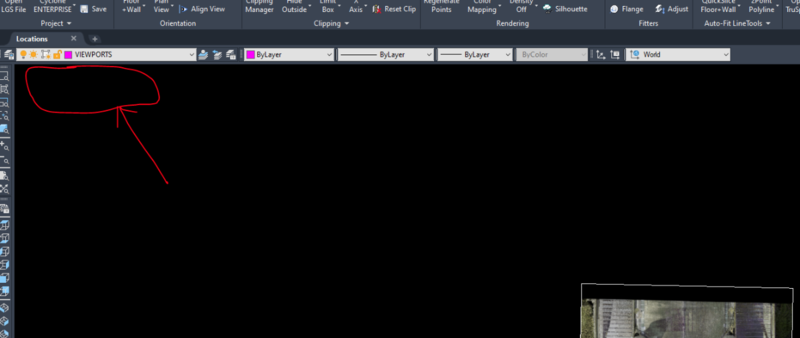

The View and display type not showing in Top LH corner of workspace until I hover over with cursor, any ideas to reinstate?
They highlight when you hover over them but should always be there if Viewport Controls are set to Display.
You just need to open Options [Display] tab, pick [Colors…], then in Context: '2D model space' pick 'Viewport control' and modify the Color to something you can see.
