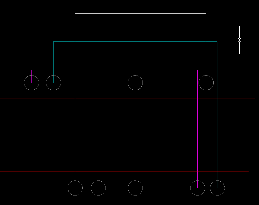

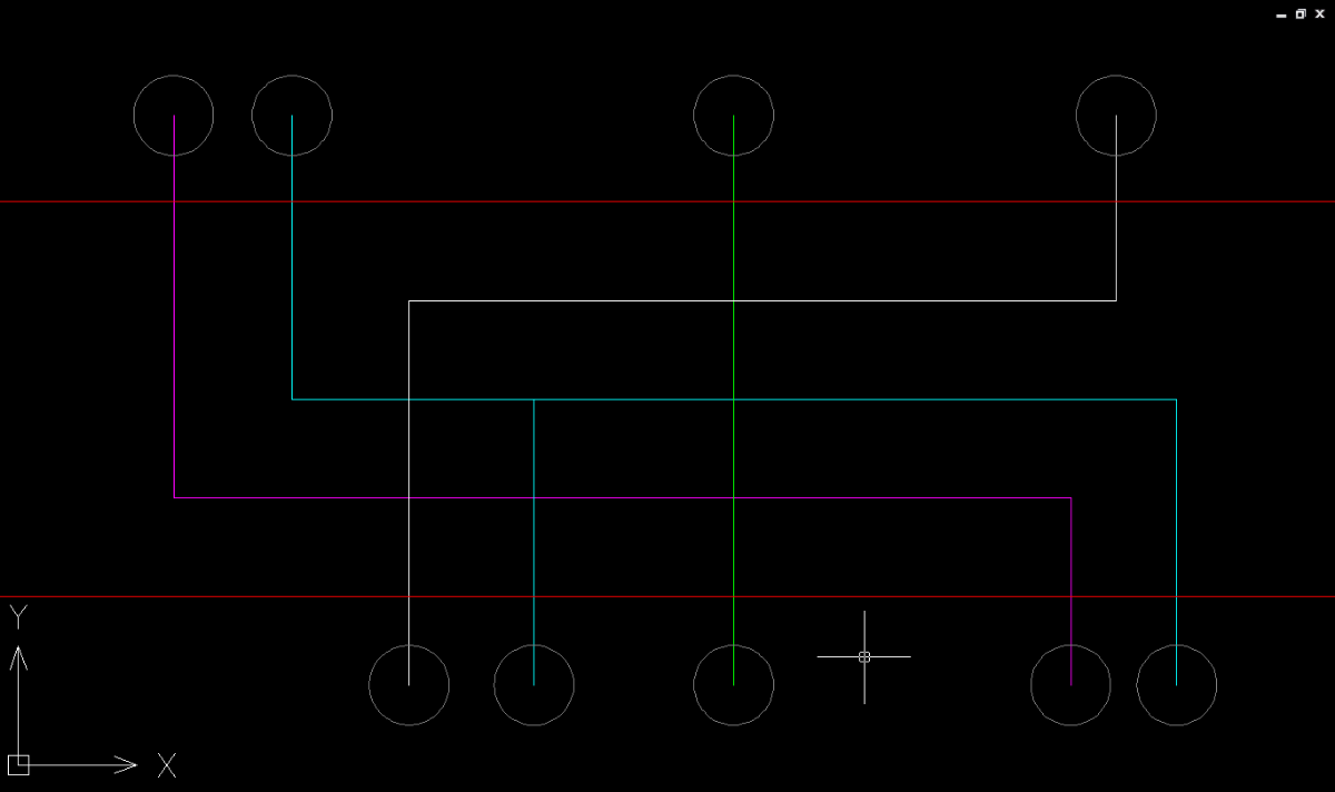

ARRY : Arrange Horizontal Lines in Y AXIS
ARRX : Arrange Vertical Lines in X AXIS
ARRYV : ARRY with start-point & gap-distance-input. ( plus : go up / minus : go down )
ARRXV : ARRX with start-point & gap-distance-input. ( plus : go right / minus : go left )
1. Select only horizontal wires to be arranged
2. Select the space by picking 2 points (extract the y value, the order does not matter)
3. complete
4. range doesn't matter

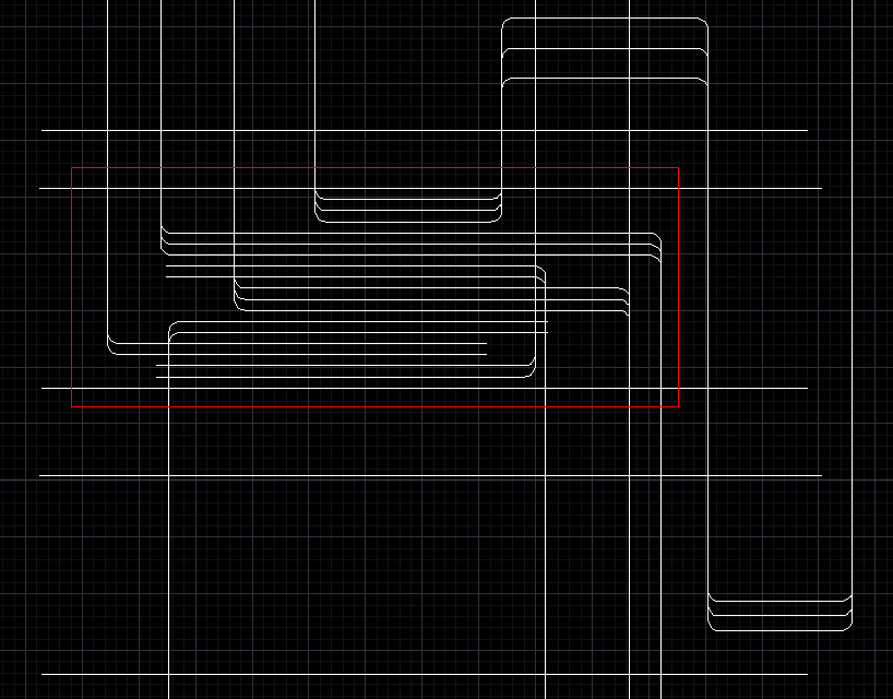

I had to stretch several times after making sketches that were not evenly spaced. So I made this.
The way it works is to get the y-coordinate of the selected lines
and divide the limit range so that there is 1 more than the number of lines
and arrange them.
Also, find the lines that have the y value of the line as the end point or the start point and move them together. (for elbow or tee)
It would be good to add a method to set the offset from the starting point rather than dividing it uniformly, and also a method to execute with the x coordinate.
However, it can be a bit slow because it searches the entire line.
but this is made for relatively simple logic diagrams or loop diagrams.
Originally I wanted to do the stretch multiple times with an offset.
But I don't know how stretch gets and modifies the specific vertices of a polyline.
So, I wrote a basic lisp with only line.
If you have any good ideas, please let me know.

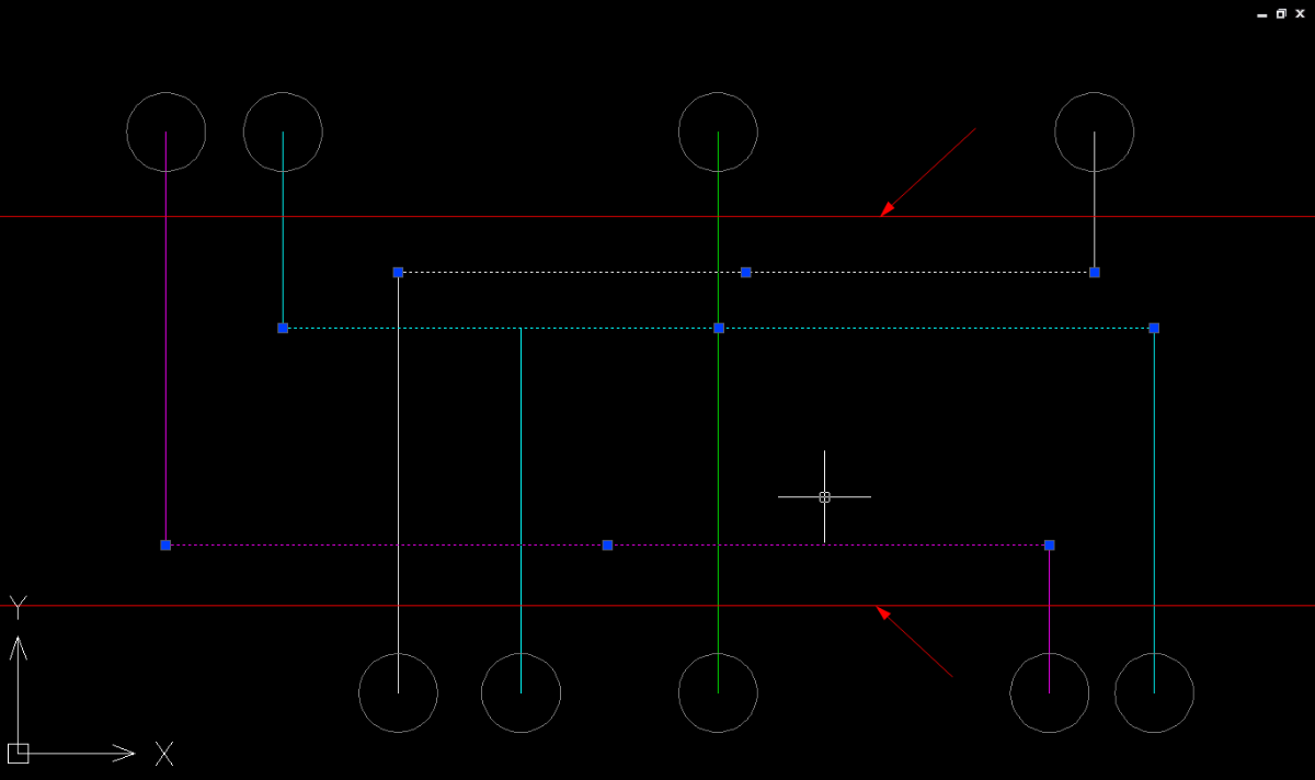

set limit
;; Arrange the horizontal lwpolylines with a constant offset in Y-axis range - exceed 2022.01.19
;; ARRYP : Arrange the Horizontal LWPOLYLINES with a constant offset (in Y-AXIS)
;; ARRXP : Arrange the Vertical LWPOLYLINES with a constant offset (in X-AXIS)
;; ARRYVP : Arrange the Horizontal LWPOLYLINES with a input offset (in Y-AXIS)
;; ARRXVP : Arrange the Vertical LWPOLYLINES with a input offset (in X-AXIS)

This is the lwpolyline version.
I studied a little, starting with extracting vertices for each polyline and output (line number-vertice number-assoc10 coordinates).
Now I know a little little bit about how to control polylines.
how to use
1. Select a polyline.
2. Select the vertices you want to stretch within the polyline. (by between 2 points)
3. Determine the y-axis area you want to arrange
There is a limitation
because the arc in the polyline can be modified as well.
In step number 2, you can edit multiple polylines at once, but only have one horizontal line per polyline.
edit - branch support.  (without fillet-end)
edit - ARRXP, ARRXVP, ARRYVP added
