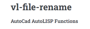

Ideally -- You would inspect and rename the photos before attaching them to a drawing. You cannot rename a file that's open in a drawing, viewer or any other software. If you did it with the drawing closed none of the files referenced would exist anymore when the drawing was reopened.
So is the Autocad use just a convenient way to arrange the photos?
You could create a temporary text file with the before and after names, close the drawing file, and in another drawing run a second LISP to rename according to the files, then go back to the first and using the list you made rename the links? It is possible but wouldn't it be easier to do the renaming in say, File Explorer which is designed to manipulate files and folders
You can run DOS type command using "shell" look at help or
