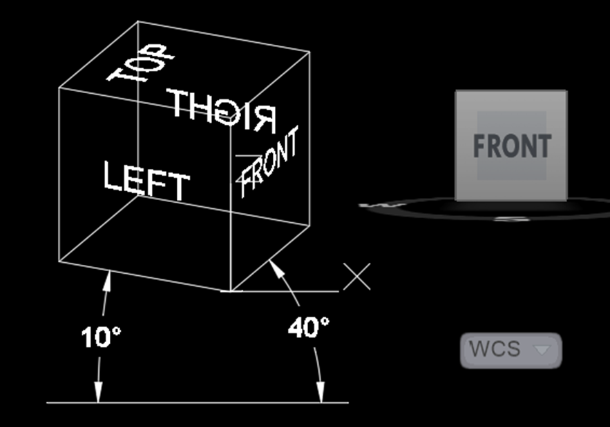

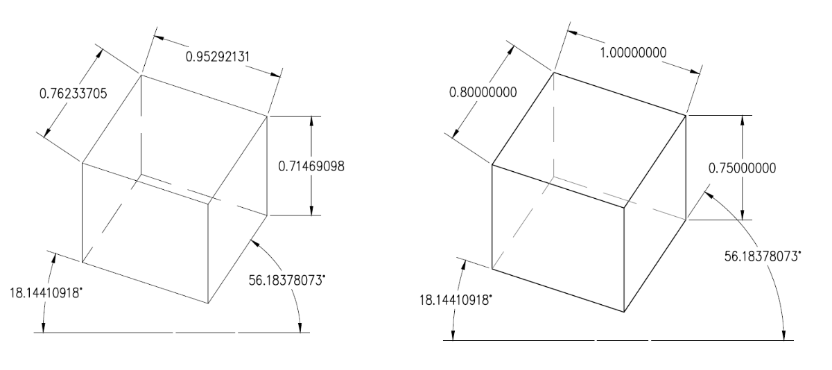

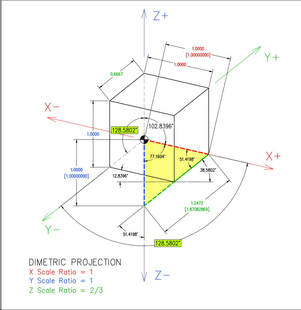

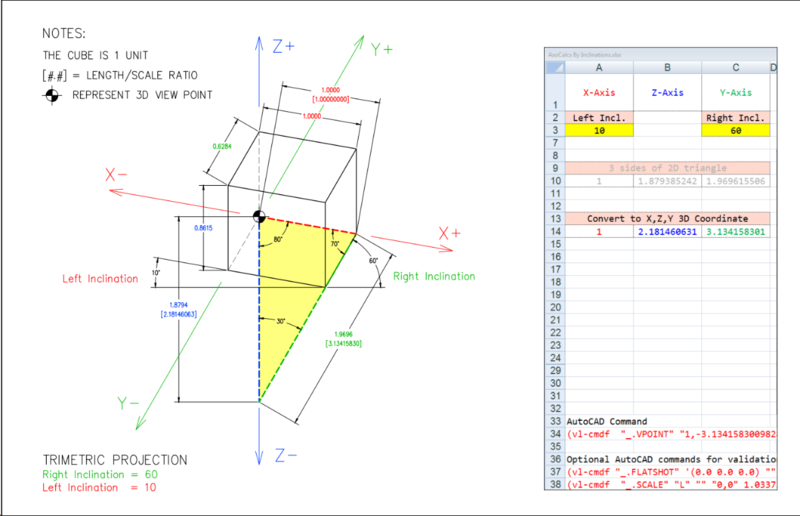

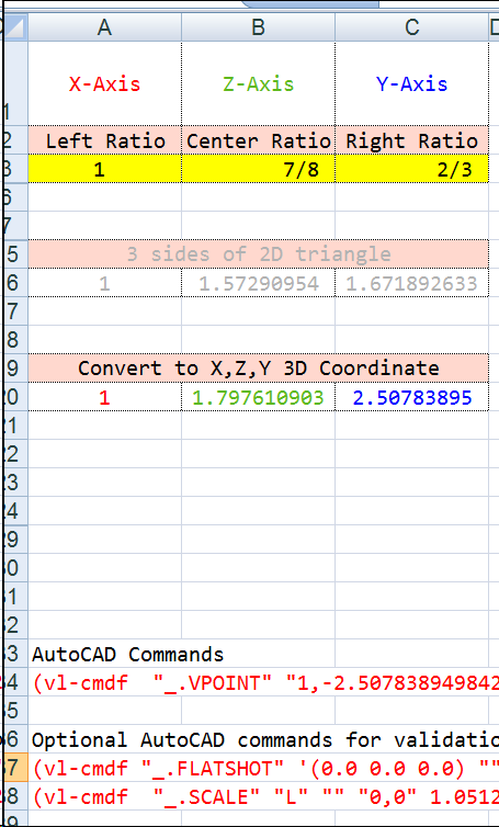

Hello everyone!
In my finding, the location of the view point as show in picture can be compute mathematically only by highlighted triangle. Would you agree?
What if other method exist?
Let me know,
Thanks!
Phh
AxonoDwg.pdf
Added simple Excel calculation by supplying scale ratio
Edited by phuynh

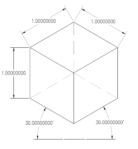

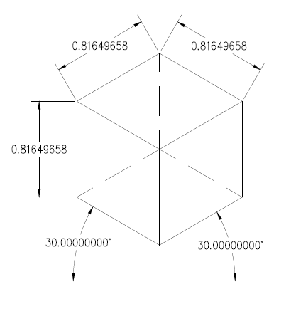

@phuynh  I'm not sure what you are asking but your dimetric projection is wrong.  The two angles that are 30° in the isometric projection are equal but not 30° for a dimetric view.  A trimetric view is any axonometric projection that doesn't qualify as an isometric or dimetric projection or orthogonal view.
There are 8 possible isometric projections. Note, an  isometric projection is about 82% as large as an isometric drawing.  The viewpoint for an isometric view is any point where the magnitude of its x, y, and z coordinates are equal.  The viewpoint for a dimetric view is any point where the magnitude of its x, y, coordinates are equal and the z coordinate may have any value.
Thank you for input,
In my understanding, as long as the 2 axis having the same scale ratio and the other 1 is not, then the view is classcify as dimetric, in this case the inclination angles have notthing to do with.

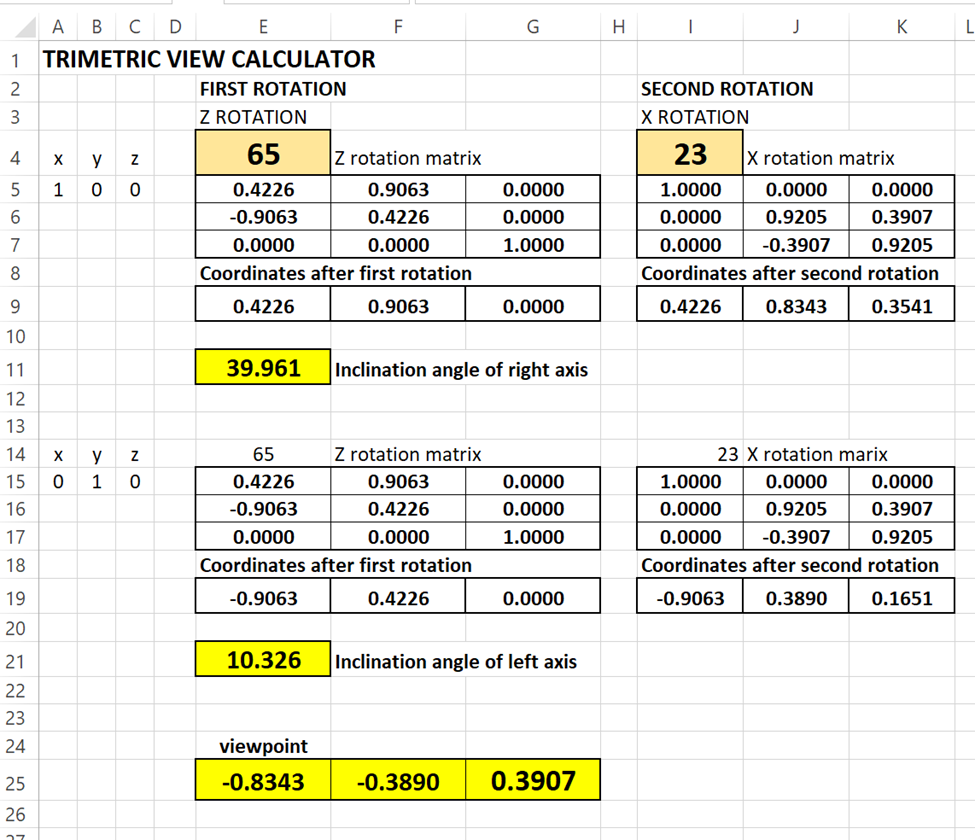

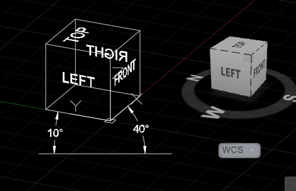

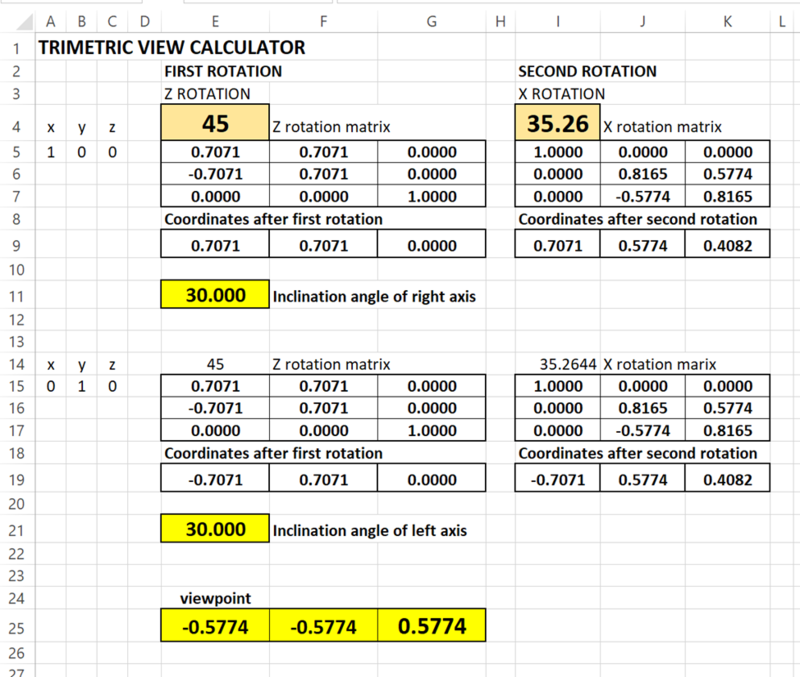

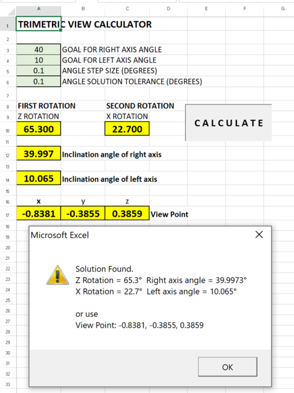

In example below using inclination angle to compute location on view point
AxonoDwg2.pdf
Edited by phuynh
It should be dimetric given that the 2 angle of the 2 axis are the same.

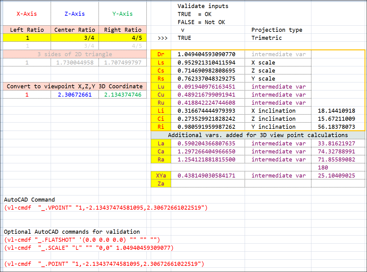

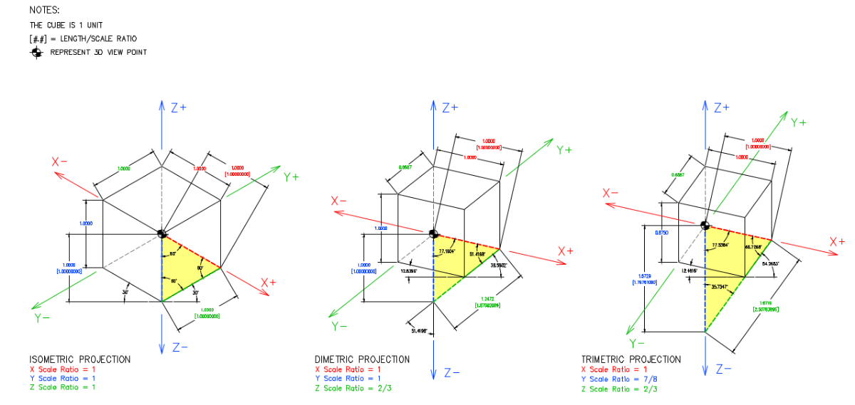

Information to anyone still interest in this subject:
The formulas are available in the internet, by search for term "axonometric calculator"
You will come to the page by author name Dave Barber with list all formula and variables how to compute, so credit to the author for his brilliant info's
Due to copyright reason, I will not list formula here, but you can easily recreate the calculation by using Excel as you see I list above.
You can validate and cross check with his result.

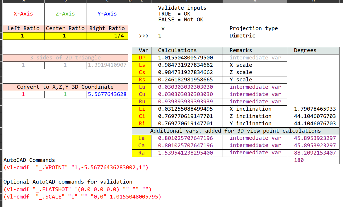

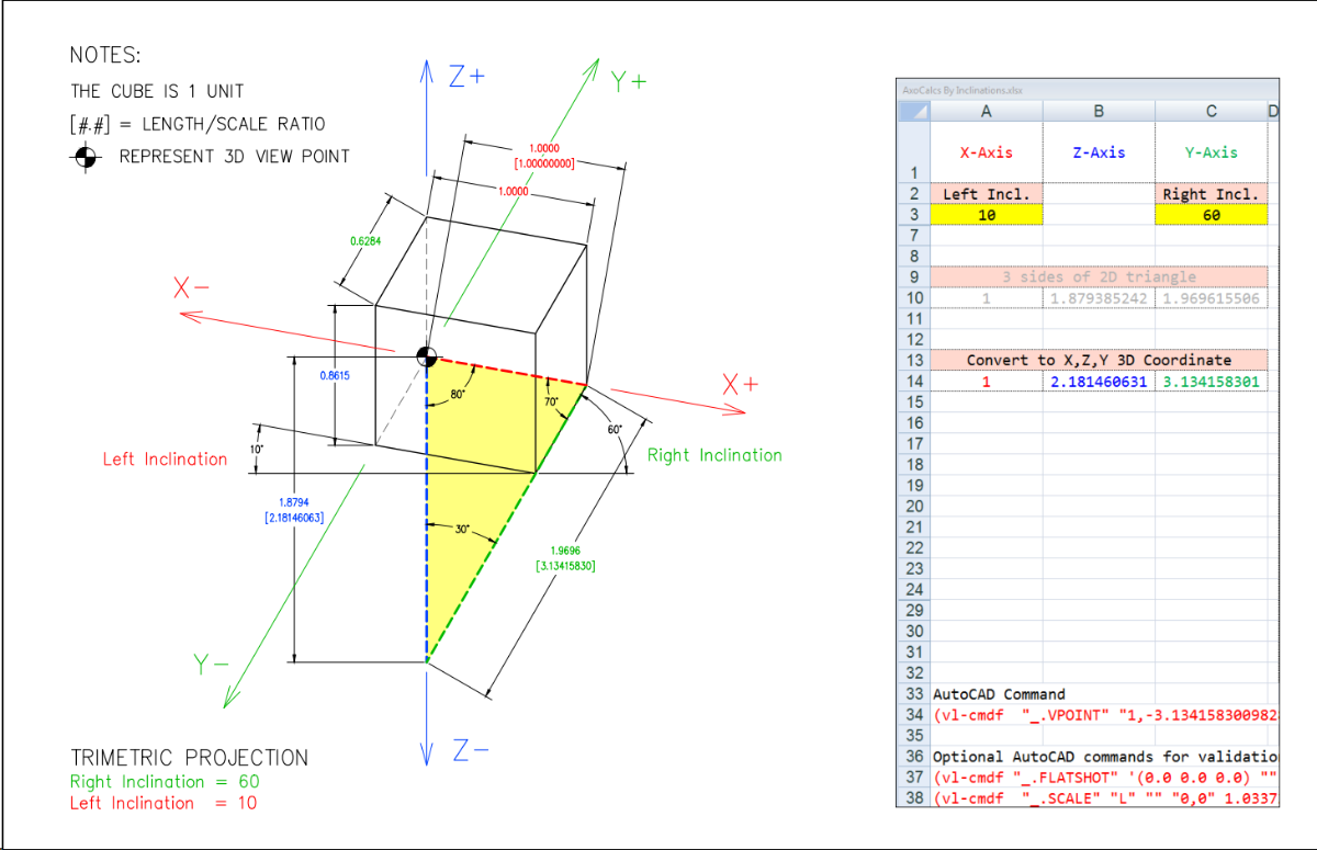

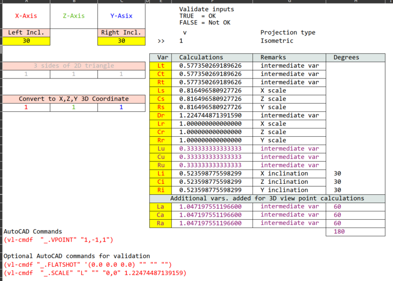

My quest is how to apply and use on AutoCAD, and I discover that I can use triangle to compute 3D coordinate that I post here!
Phh

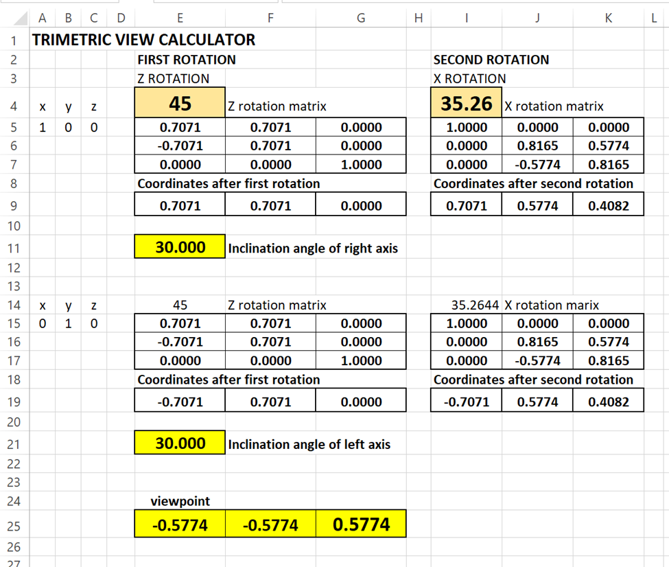

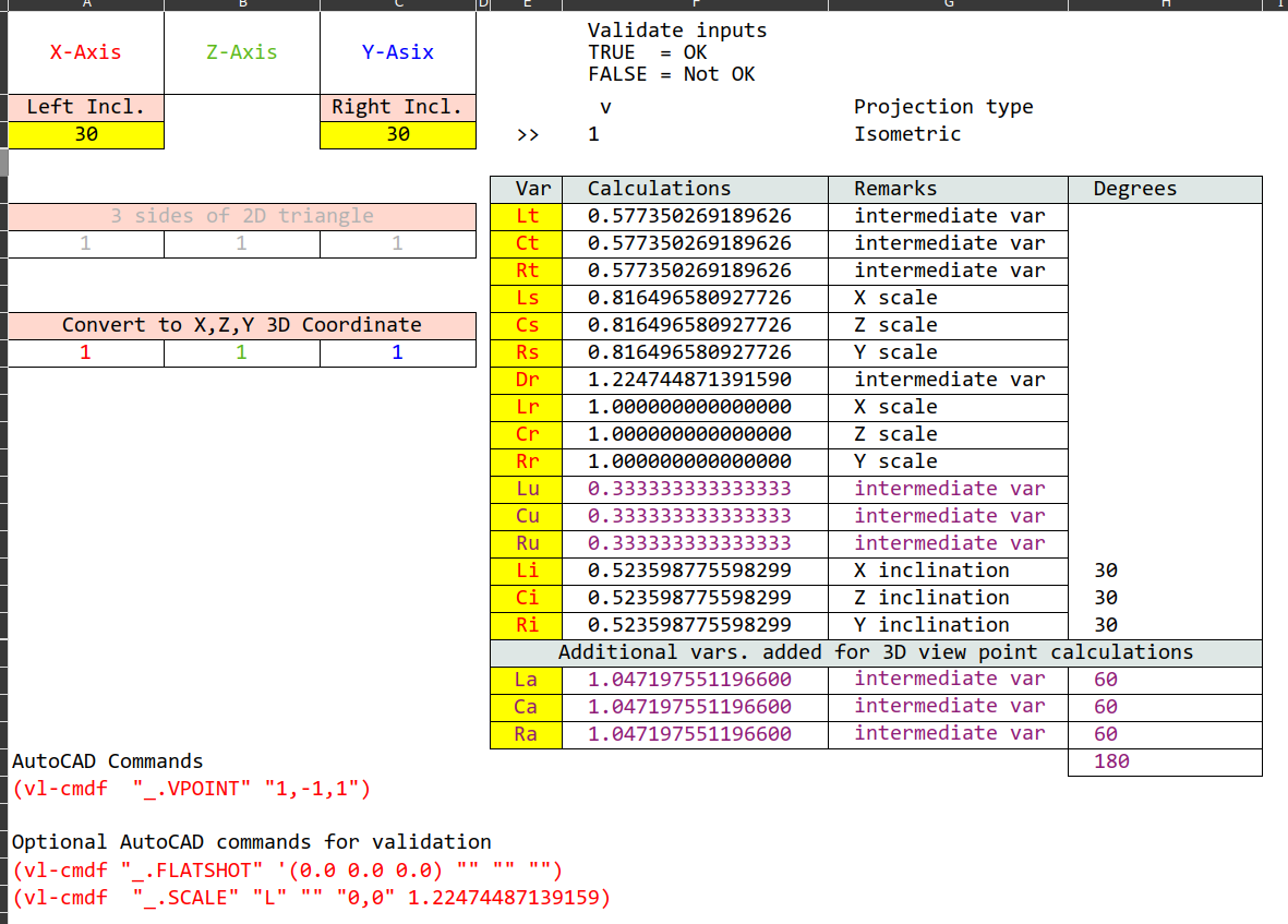

Updated, noted that Vars "La", "Ca" & "Ra" added for calculate position in AutoCAD
Explanation of vars. La, Ca , Ra
Calculate highlighted 2D triangle (note all angle are all in Radians)
intermediate var La (angle opposite to left inclination or X inclination)
La = 90° - Ri = (PI()/2) - Ri
intermediate var Ra (angle opposite to right inclination or Y inclination)
Ra = 90° - Li = (PI()/2) - Li
intermediate var Ca (since known the others 2 angles simply subtract them)
Ca = 180° - (La + Ra) = PI() - (La + Ra)
At this point all 3 angles are known, then using Sine Rule finding side length
For left inclination
=(Lr/SIN(La)) * (SIN(La))
For Center inclination
=(Lr/SIN(La)) * (SIN(Ca))
For Right inclination
=(Lr/SIN(La)) * (SIN(Ra))
2D length of triangles are known, to convert to 3D coordinate
simply divide 2D length to corresponding scale ratio
for X coordinate value (corresponding to left inclination) / Lr
for Y coordinate value (corresponding to center inclination) / Cr
for Z coordinate value (corresponding to right inclination) / Rr
phh
Edited by phuynh

http://www.theswamp.org/index.php?topic=41965

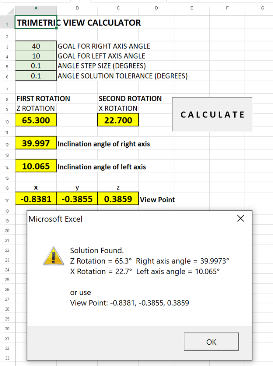

Thank you for the information, I also struggle for sometime and how to use it in AutoCAD.
Since now I can compute any scale ratios or incline angles, my next step will be writing code in lisp.
Cheer!
Edited by phuynh
Update, added explanation of vars. La, Ca , Ra, see old post above
Phh

Marko,
First, I would like to appreciate your point, the whole subject of axonometry projection will be vast and difficult to take on without research carefully.
But here the post as you see on the title, I just indicate that what finding is a way to obtain “ 3D viewpoint on AutoCAD” can be compute and what I am represent here and what I ask for if there is other way to do it.
I consider myself as not an expert, learning few tips here & there to complete my goal to make living, finding answer for what I seek, your help and advice always appreciated.
I believe within confine of my post with some variables seem unclear, so I continue to update as I re-read my posts, that all.
Regarding, the source of the formula I clearly state that something to do with copyright, so I try to point out where I got them.
Anyway, I will take your advice seriously, will have your code, do some study, probably couple of year then when I completely understood, then that time will restart conversation.

Explaining how I am getting here,
Here I go,
About 10 years ago,
One day my boss came, and he said, our company have about 200 solid model parts that we want you to produce 2D drawing’s isometric view for marketing and send to client with the following parameters left inclination 10 degrees, right inclination 40 degrees (or X scale 1.0, Z scale at 1.0 and Y scale 2/3) etc.
Yes boss, that easy as I though!
At first, I try AutoCAD isometric, but this view only produces inclination angle of 30, 30 and it not falling in with the specification requirement 10, 40.
At this point I think yeh, I may do some quick eyeballing to get 10, 40 inclinations and at same time I realize that there must be a better way that setting up the viewpoint so that when I do “flatshot” it can re-produce 10, 40 inclinations, but how.
I set out to forum look for information of this type, but I come up empty.
In my quest of looking answer, most of info’s explaining type of axonometric projection and so for but hardly explaining how to get viewpoint.
So, my point here is how to get viewpoint in AutoCAD that can predictably & consistently when I know either inclination angles or scale ratios of XYZ A-axis,
Of course, trial & error part of process, I use Excel to compute, create some AutoCAD command so I can test them out quickly by copy & paste.
My intention to post in this forum is what I try validating my finding, I also asking if any better way to get the result.
 I accept all your opinion, teaching and always appreciated,
Please spare me for my bad English, I hope I learn a thing or two!
Thanks!,
Phh
@phyunh First off, I agree that the view in your first post is a dimetric view.  What threw me off was that in a typical dimetric view the axis of symmetry is vertical. In your dimetric view you have set the axis of symmetry to 38.5802 degrees.  It’s not clear why.
To create an axonometric projection in AutoCAD you can either move you (the observer) by changing the viewpoint or by rotating the 3D object in 3D space. If you rotate the object the axonometric projection can be seen in a principal view. Typically the front view.
Let’s look at the “rotating the object” method. The following assumes we are looking at the front of an object in the AutoCAD front view and therefore viewing the object perpendicular to the world XZ plane. To rotate an object to an isometric orientation you can first rotate it (using rotate3d) by + or - 45 degrees about the Z axis and then 35.2644 degrees about the x axis. The angle 35.2644 is the angle that a diagonal of a unit cube makes with its base, the arctangent of (1/ sqrt(2)).
To rotate an object to a dimetric orientation the first rotation is also 45 degrees about Z but then any angle (except +/- 35.2644) about the x axis.  This second rotation tilts the object up or down but maintains a dimetric projection. The dimetric view you posted would require a third rotation about the world z axis to change the slope of the axis of symmetry from the vertical default to another angle (e.g., 38.5802).
A trimetric view with pre-specified angles of inclination for the two non-vertical axes can be created in a similar fashion if the two angle of rotation are known. It’s no simple task to determine these angles as you have noted!  I found the task intriguing so to help determine these angles I created the attached Excel file Trimetric View Calculator.xlsx.  To help me debug the spreadsheet I included many intermediates calculation values on the sheet including rotation matrices and computed points I could compare with AutoCAD values.
To use the spreadsheet the user enters values for the rotations about the Z and X axis.  The resulting orientation of the right and left inclination axes are determined as well as the coordinates of a view point. The two angles can be used to rotate the object yielding the corresponding axonometric orientation when view from the world front view. If you do not want to rotate the object you can use the view point coordinates to yield the identical axonometric projection.
As an example let’s assume that we would like to create the trimetric view you used with a left inclination of 10° and a right inclination 40°.  There are two angles for rotating the object in 3D that we need to determine. The first is the angle of rotation about the world Z axis while the second rotation angle is about the world x axis. In the following example setting Z to 45 and X to 35.2644 we see that the angle of inclination for the two axes is 30°. That is, an isometric view. The Excel file also computes a viewpoint that would yield the same axonometric projection (-0.5744, -.5744, 0.5774). Obviously, this would yields the same isometric view as using a view point of (-1,-1,1). The Excel file does not bother to scale the view point but leaves it as a unit vector.
With this worksheet it requires a bit of trial and error to determine the two rotation angles (or a viewpoint) that would create the 40° right axis and 10° left axis. For example, a guess of 50 for the Z rotation and 20 for the X rotation yields 22.176 and 16.013 respectively.
A few more guesses adjusted by the results of previous guesses yields and angle of 65° for the Z rotation and 23° for the X rotation resulting in a trimetric projection with the right axis at 39.961° and the left axis at 10.326° (see below).  This may be close enough for a pictorial drawing.
If you prefer to use a viewpoint then it is available too (-0.8343, -0.3890, 0.3907). This assumes a base point of (0, 0, 0).
To make this process more automatic and remove the guesswork I wrote an Excel/VBA program to cycle through combinations of the two angles to search for an acceptable solution.  The file “Trimetric view calculator VBA.xlsm” contains the VBA enhanced version. The program is not elegant as it uses a brute force approach incrementing the X angle from 1 to 359 degrees before incrementing the Z rotation angle.
Here are the results where the tolerance was set to 0.1° and the angle increment step size to 0.1°.  The compute time was about 15 seconds on my old PC.
The result by rotating the object.
The result by specifying a view point.

@lrm, i agree with your method of calculation in general, yes it works with some caveat, for example the precision of angle (or scale ratios), let say within 6 digits it maybe problematic.
Phh
In my opinion, 2 methods of obtaining axonometric viewpoint in AutoCAD programmatically by given inclination angle input or scale ratio input. My use of inclination angle is 1% and scale ratio is 99%. I find myself editing a lot after "flatshot" so the scale ratio is really importance to me, give me the ability to know ahead what I need to do and so for etc.
Dave Barber calculation methods and his formulas are best, I did apply & check the accuracy when try his formula to calculating 3D view point, at a minimum 6 decimal digits but it turn out very high 13 or 15 (AutoCAD, Excel)!
Also in his calculation the "DR" intermediate variable give me ahead how much I need to scale after "flatshot" to match the drawing unit.
Regarding "DR" intermediate variable, it so importance that I end up planing to write separate routine as lisp reactor so it always available in my AutoCAD session.
My plan to obtain DR from AutoCAD = DR intermediate variable = function calculates VIEWDIR
Did you know that VIEWDIR system variable is actually 3D viewpoint?
For me this really fun! brain teasing, feel like going back to school to rediscover what I was missing.
Cheer! my 2 cents.
Phh
Shown here are the effect to "DR intermediate variable" in simple 1" cube in AutoCAD "SW Isometric"
AutoCAD "FLATSHOT" without any scaling
AutoCAD "FLATSHOT" with custom script scaling based on "DR intermediate variable"
Just like going back to old school style of manual drafting, 2D drawing!, start out drawing 1 unit length with angle 30 degrees...
Phh
The effect "DR intermediate variable" in simple 1" cube in AutoCAD with scale ratio input,
X-Axis = 1
Z-Axis = 3/4
Y-Axis = 4/5
On the left, with no "DR" scaling, on the right with "DR" scaling, see "(vl-cmdf  "_.SCALE" "L" "" "0,0" 1.04940459309077)" and it easy to visualize
Phh
Edited by phuynh

"DR intermediate variable" compute using AutoCAD system variable "VIEWDIR"
I know it shouldn't be that long, but I tense to keep all notes and comments so I track what I'm doing.
The routine compute and return Dr variable value at command prompt based on current "VIEWDIR"
