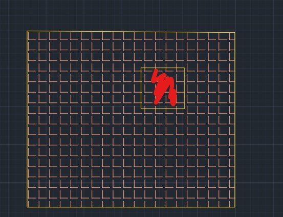

Come si elimina un riempimento all'interno di un quadrato? Grazie
You don't.  Create two squares and then invoke the HATCH command.  In the Hatch dialog box find the option Select Objects then when you are back in your drawing select both boxes.  Or select the Pick Point option then pick a point between the boxes.
Edited by ReMark
But if I still want to cut the screen of the smallest square, is there a way?
Hatch patterns can be trimmed.
