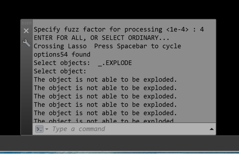

BigAL: The overkill command is very good! I knew this one but the problem is that I wasn't using it properly! When I check all the boxes in the upper section of the overkill menu, it does what I was hoping for! I have used Selectsimilar to erase all the text boxes following the explode command!
Marko: When I try your routine, it seems that a lot of blocks are not able to be exploded! Maybe I'm doing something wrong? I'm not familiar with the fuzz factor so I've tried some different numbers but the result is the same. Here is a screen capture of my command line!
Thanks again have a good day!
FYI.,
When specifying fuzz factor, be sure you know what are you doing... Ordinary fuzz values go from 0.1 to 0.00000001... (all are decimal digits and represent small values; for easier writing of numbers that are far too small - like 0.00000001, you can simply write 1e-8...). That sign : - between 1e and 8 is very important... If you wrie it like 1e+8, it means you wanted this : 100000000...
You used number 4, meaning 4.0 DWG units, meaning that your drawn entities are in very big scale and that is fairly unusual... IMHO, my defaults I provided in the code should work well in every usual situation, even you are working in some specific measurements, DWG units are DWG units... So 1e-4 : 0.0001 was well proposed... If you don't like it, change it, right at beginning of the code... All should work well, you simply have to tap ENTER 2 times when executing...
As for exploding process : I don't know your all blocks have explodable parameter set to be enabled, or if you are facing some entities not usual and standard (some 3rd party software you are importing...)... Any way, make sure your LAYERS where entites reside are unlocked - I assume you have been checking this with your first setting and those recording macros...
If you want, you can go selecting manually to avoid locked LAYERS scenario : you only have to select it with mouse, and not like I prompted : pressing ENTER when asked for selection... I predicted that you want to do things standardly : (setq ss (ssget "_:L")) was the line that manages just this and it's already coded...
Hi Marko!
Thanks for the explaination! I understand the fuzz factor part!
For the exploding process, all layers are unlocked. I just pasted two rectangles as blocks to make further tests and it seems that even if I select all, it will only explode one of the two blocks! As for If it is explodable or not, I went to my test drawing that I've sent and if I use the explode command, it would explode all 31 blocks in the drawing making 144 lines but when I use your command it explodes 1 block leaving 30 blocks intact and creating 12 lines. Is there something I'm doing wrong?

I see...
I've neglected the fact that EXPLODE inside LISP don't work with selection sets...
To ovecome this issue, there are 2 ways :
1. insert this line before (vl-cmdf "_.EXPLODE" ss) :
(initcommandversion)
2. experiment with undocumented system varibale : QAFLAGS...
Place inside error handler :
(if qaf
  (setvar 'qaflags qaf)
At beggining of main part of routine, get value of QAFLAGS :
(setq qaf (getvar 'qaflags))
Then place this before (vl-cmdf "_.EXPLODE" ss) :
(setvar 'qaflags 1)
*** It's strongly recommended that you place after (vl-cmdf "_.EXPLODE" ss) :
*** Messing with QAFLAGS may lead to some unusual behaving of AutoCAD, so if you can, alwasy avoid it...
[ Don't forget to localize "qaf" variable in main (c:doit) definition : (defun c:doit ( / *error* ... qaf ... ) ... rest of routine ... (*error* nil)) ]
So, my recomendation is - use first fix...
HTH.
