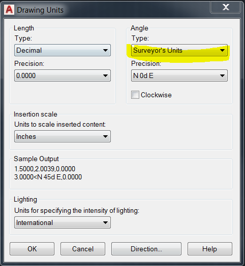

Sounds like your calling an undeclared variable. or you need to set the units.
