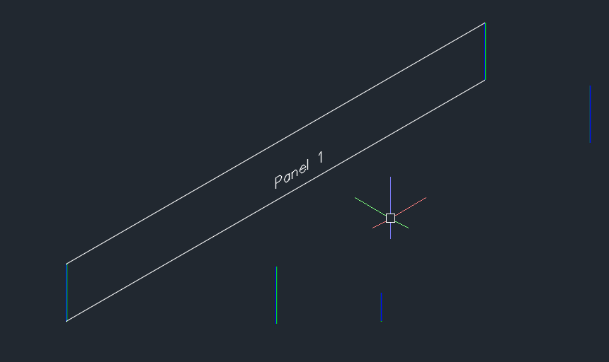

Hi all,
I need a help from CAD experts because I am stuggling with a 3D drawing.
I got dwg file with 3D measurements of facade from surveyor (upper line, bottom line and 50-60 windows measured in all four corners) but to proceed with work I need 2D drawing of facade.
It is easy to get 2D drawing when facade is straight but building is half straight and half curved. When you look from top, building is shaped as letter "J".
If I use reference line and side view, facade will be shorter then it accually is becase of ortogonal projection.
Is there a soultion in AutoCAD Civil, Inventor or another program where I can unroll facade so that I get right dmensions between windows?
I hope somebody can help me ;)

Here are two sample files.
Windows_lines_measured.dwg: measured lines and spline closing curved part.
Facade_teoretical with measured lines: I have overlaped measured and teoretical facade.
If I can get teoretical facade (white part in dwg) unrolled it will solve all my problems :)

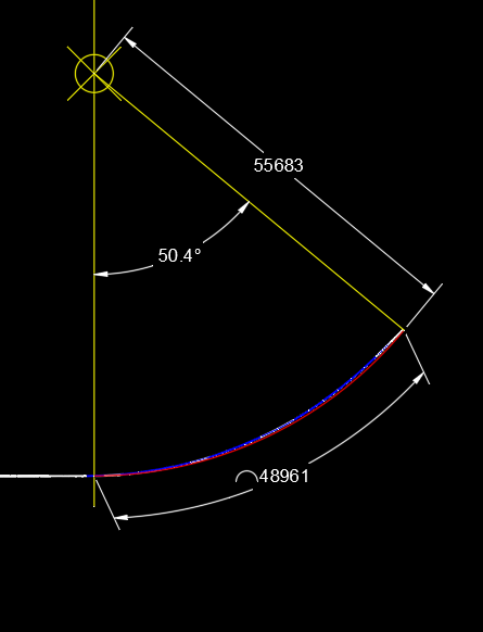

Create an arc that approximates the curved wall then dimension its arc length to get a very good approximation of the wall's length. You can do something similar to determine window placement once you know the radius of the wall
distance = radius * angle (radians).

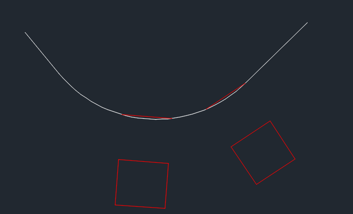

Don't know If I got your problem correctly. See my suggestion attached.
You can simplify the result by redrawing as there are only straight Lines and Rectangles.

With your suggestions I have managed to solve a problem. I used approximation of a curve and redraw arc lenghts to straight lines.
@scj, I have overlapped your drawing with mine and it seems like it is the same (within 1cm difference).
Many thanks for your help.
