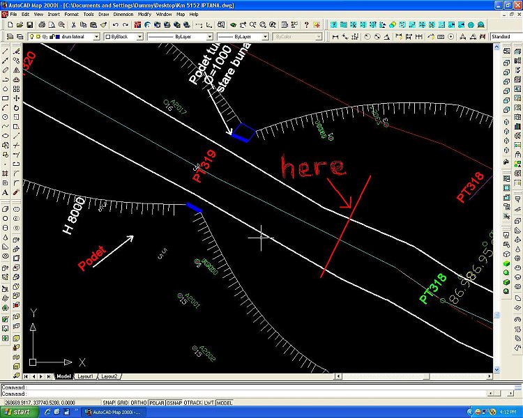

Hey there. My mates asked me to ask you guys about a LISP or a way to do transversal profiles (the ones created by TopoLT). We have them on paper, and now we have to create them on autoCAD... now you would normally ask me how on earth do we have them on paper, and not on autocad.. well we got them from someone. So we have a drawing (a road , measured and all), with transversal profiles, BUT the profiles are wrong (wrong Z and dist. between points).. AND we got the good profiles, both digitized and printed. So any way to create a lisp that asks for specifi 1st point, you click somewhere, then specify Z for that point, you enter Z, then it asks specify next point distance, you enter the distance, then that point's Z, you enter it, and now you have 2 points, so the LISP can create a line from the direction of the 2.. you need 2 points to create a straight line... and since you now manually entered tose 2, the lisp now only asks for next point distance, and for the point's Z. OR if it would be a little bit easyer, a LISP that reverses the TopoLT profiles... from profile by TopoLT, you put it on to a drawing (so from 2D pls as we have hundreds of profiles that we need to put back into the 3D road..

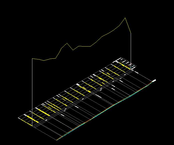

So here's what i really want. The marked polilyne, from picture 1, to the line on picture 2 (so when you look from TOP view, you see a straight, but when you look FRONT, you see it as in picture 1 - so Z and dist between points will remain unchanged).
And thank you for the lisp, testing it, but not fully working in my hands. Also for the tutorial about LISPs, i learned quite alot out of it..

Do you want to draw a 3D line (including elevations) along the cross-section location in plan view from the info taken from the profile??
That's what it sounds like to me.
It would be pretty awesome if you could go as far as write the lisp to where he could just click the section line in the cross section, tell it what the cl was then select the alignment and it would automatically plot the 3d poly in plan view. I suppose that would take some hefty coding.

last lisp is kinda OK, but 1 thing.. we need the points.. your lisp creates the cross section seen from top view, but there are no point with Z's. Now i understand what do we need. we only need the points, that have the right Z elevation.. so about 5-6 points in one line with different elevation, but with different distances between them. (point, as the green circle with the dot in center..). so when we click on the point it will show it's correct Z. Your lisp is ok, but when you switch to front view, you can't select the point (where 2 lines meet - and if i put a circle there, it's z is incorrect). It's no problem if you can't make it, as you showed that you care, and made 2 already.. what we do now is simply look at the drawing from top view, copy a point with a random Z, modify it with what we need (ex. 98.04), then paste it again form 3.42 units away from the first one, with a different Z, then paste again at 4.87 units from second one, change the Z again, and so on. basically no line between them. only a couple of points with Z and a distance between them. your lisp creates a line, but i can't select the point (to check it).. am i missing something?

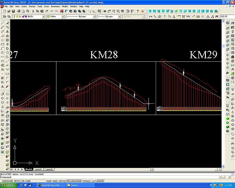

Rescale your dwgs in both x and y to be true scale at 1:1 remove all other line work other than the surface line then simply use rotate3d around x axis this stands up the surface so you now have x,y,z as true values you need to line them up first before rotating so say ch 20 is at y=20 and x is at 0. You may need a datum line depending on your z values to make the rotation simpler.
