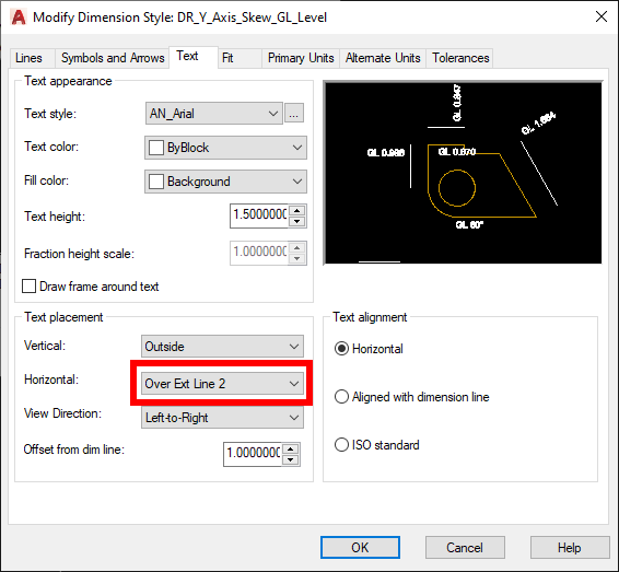

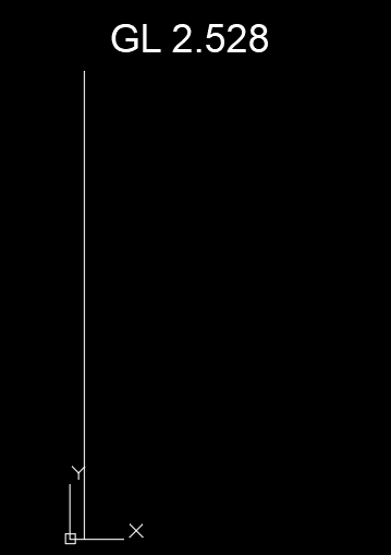

The dim (attached) has this enabled and also has the lines suppressed in the Lines tab.
The lines still shows even though this is checked.
Is this a bug or any way to use Over Ext Line while not having the lines shown like below:
Settings of the dim style below. Note: If At Ext Line is chosen then it works and the lines don't appear.
Dim.dwg
